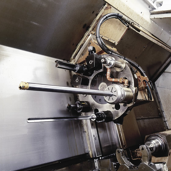

Within the realm of twist drills, various options exist, depending on whether or not you have access to through-coolant capability. According to Brandon Hull, director of product management and business development for Brookfield, Wis., cutting tool manufacturer Guhring Inc., an HSS or cobalt parabolic-flute drill is the ideal choice for making deep holes if through-coolant is not available.
“[A parabolic-flute drill] is extremely efficient for deep holes because the larger flute opening aids in chip evacuation, meaning you can drill with fewer peck cycles,” he explained. “If you have a 0.500 ” drill, for example, instead of pecking every 0.145 ” deep, the way you would with a standard-flute form, you can sometimes go up to 5 diameters without pecking.”
Pecking, or withdrawing the drill from the hole to remove chips, can introduce problems, especially in deeper holes, he explained. At every peck cycle, there is an opportunity for a chip to get in front of the drill tip, reducing cutting efficiency and potentially increasing runout. Some newer machines combat this with a chipbreaker cycle, which partially rather than fully retracts a drill. This allows the drill to create chips without allowing chips to get in front of the point.
However, with high-pressure coolant, pecking is unnecessary, and a coolant-fed carbide twist drill brings a plethora of advantages. “It’s one of the fastest ways to drill a deep hole,” Hull said. “The problem is, they can be very expensive compared to a gundrill, but your productivity increase is huge—five to six times, potentially more. You’re going to get better chip evacuation, and you can drive the drill much harder. If you can afford it at the outset, you’ll save money in the long run.”

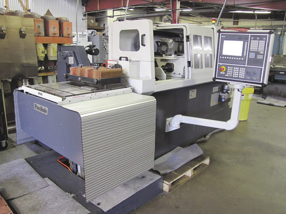

While standard machine tools can certainly be used for deep-hole drilling, there are several advantages to using specialized drilling machines in some applications.
While a gundrill may not be the fastest drilling method, Jim McGaffin, product manager for Absolute Machine Tool Inc., Lorain, Ohio, said the concentricity and surface finish simply can’t be beat.
“On a dedicated gundrill, the part is counter-rotated in the opposite direction of the drill,” McGaffin said. “Even the best horizontal or vertical drills will have looser concentricity, because they lack counter-rotation.”
In addition, he continued, exotic materials, such as Hastelloy and Inconel, pose no issue for a gundrill’s high-torque motors and high-pressure coolant.

Leese & Co. uses a PreciHole Micro Gun Drilling Machine from Absolute Machine Tool for many of its deep-hole applications.
“You really won’t see a drop in feed rates, concentricity or surface finish [with a gundrill],” he said.
For example, the Precihole Micro Gun Drilling Machine, distributed in North America by Absolute, is for high-concentricity medical applications, such as bone screws. McGaffin explained that the centers of bone screws are drilled in part to reduce weight, but also so that they can bend when necessary; a concentric hole is essential to allow the screw to bend properly. The Micro Gun Drilling Machines can drill counter-rotated holes from 0.040 ” to 0.250 ” (1.016mm to 6.35mm) in diameter at spindle speeds of up to 25,000 rpm.
