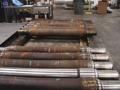

A rail axle is refurbished at Seco Machine. Image by A. Richter.

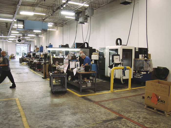

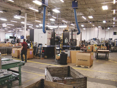

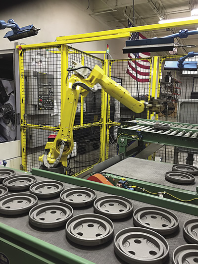

Seco operates three robotic work cells, ranging from “down-and-dirty turning” to high-capability machining with a main spindle, subspindle and cutting tools driven by the Y-axis, according to Seccombe. “We could do almost anything in that one machine,” he said of the latter cell, “while reducing setups and changeovers.”

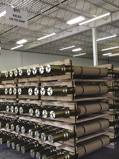

Axles ready to ship (above) and ones ready for refurbishing (below).

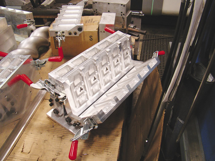

Since joining Stucki, Seco Machine also has become adept at making molds for its low-pressure urethane line. Seco will even make molds for external customers, but doesn’t market that service because its internal requirements typically consume all of its capacity, according to Seccombe.
Traditionally, he noted, molds for urethane were made of steel and served as heat sinks. That required putting a lot of time and energy into heating a mold so it would stay warm. “We had better luck rethinking that and going with aluminum,” Seccombe said.
With an aluminum mold, the heat primarily goes into the part instead of the mold. This significantly reduces the amount of energy required to pour urethane into the mold. “We would rather have a lighter, less-inductive material and be able to put that heat directly into the part,” he added.
Overview of Seco Machine’s shop. Image by A. Richter.
A robot tends a work cell. Image courtesy Anne Kocher, Stucki.
To produce the molds, Seccombe said Seco employs full 5-axis machining as opposed to positional 5-axis machining. In addition, Seco switched from cast aluminum mold components to billet aluminum bar stock when it took over the pour line from Stucki. “Take any piece of aluminum that is cast and it’s going to move as you machine it,” he said. That movement might require weeks of hand working to get pieces to fit properly so they hold the liquid. In contrast, Seco can complete a three- or four-part mold in a day.
“We premachine one side for fixturing and then machine the other five sides in the 5-axis machine,” he said. “They are watertight right out of the machine.”

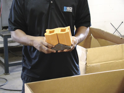

And sometimes urethane meets a different type of metal, such as an iron casting. “We can bond urethane directly to a machined component as part of the pour process, as opposed to finishing parts and gluing them together,” Seccombe said. The urethane then serves a wear component and is replaced when the part is refurbished, saving costs compared to refurbishing metal-to-metal parts.

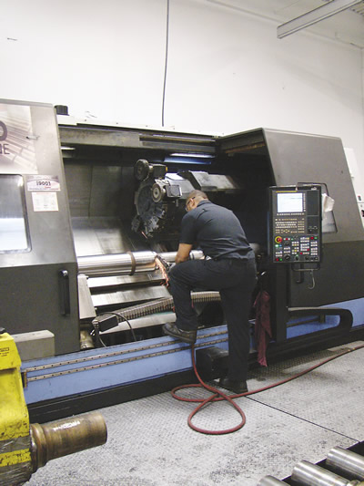

Another money-saving method Seco Machine introduced was to perform three axle processes—one for new axles, one for refurbished axles and one for axles with too much damage for refurbishing but that could be turned to the next smaller size—on a standard lathe instead of a special axle lathe. Seccombe explained that the American Association of Railroads governs production processes for the rail industry and said the work must be done on an axle lathe.
Seco Machine can bond a urethane wear part to a metal component. Image by A. Richter.
“We said, ‘We’ve been turning shafts forever and don’t understand why a standard lathe won’t work,’” Seccombe said, adding that an axle is just a big shaft. “We had a machine that was barely able to [hold one shaft but we] proved it out. Traditionally, that’s been done not only on three different pieces of equipment, but at three different plants.” Seco performs all three axle processes in one machine.
He added that Seco has three of those lathes. “They are 700mm machines, with 24" chucks.”
Even for refurbishments, Seco holds a ±0.0005" (±0.0127mm) tolerance for the journal bearing on a 9'-long (2.7m) axle, probing it end to end. “That’s a very tight tolerance considering it’s a used piece of steel,” Seccombe said. “It’s really making silk out of a sow’s ear.”
