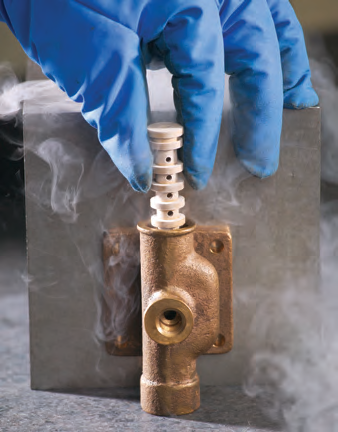

Stark uses a liquid nitrogen-based shrink-fit process to assemble certain parts.

Wilkof: We’ve become very good at shrink-fitting two parts that need an interference fit by freezing one of the parts in liquid nitrogen so it shrinks ever so slightly. When you mate them, the frozen part warms to room temperature—which takes a few seconds—and it’s better than a press fit. They will never come apart. One application is in assembling valves where a stem goes inside a sleeve. We often recommend the process to customers where the fragile nature of the part or its geometry make it important not to stress it, as would happen in a press fit.
