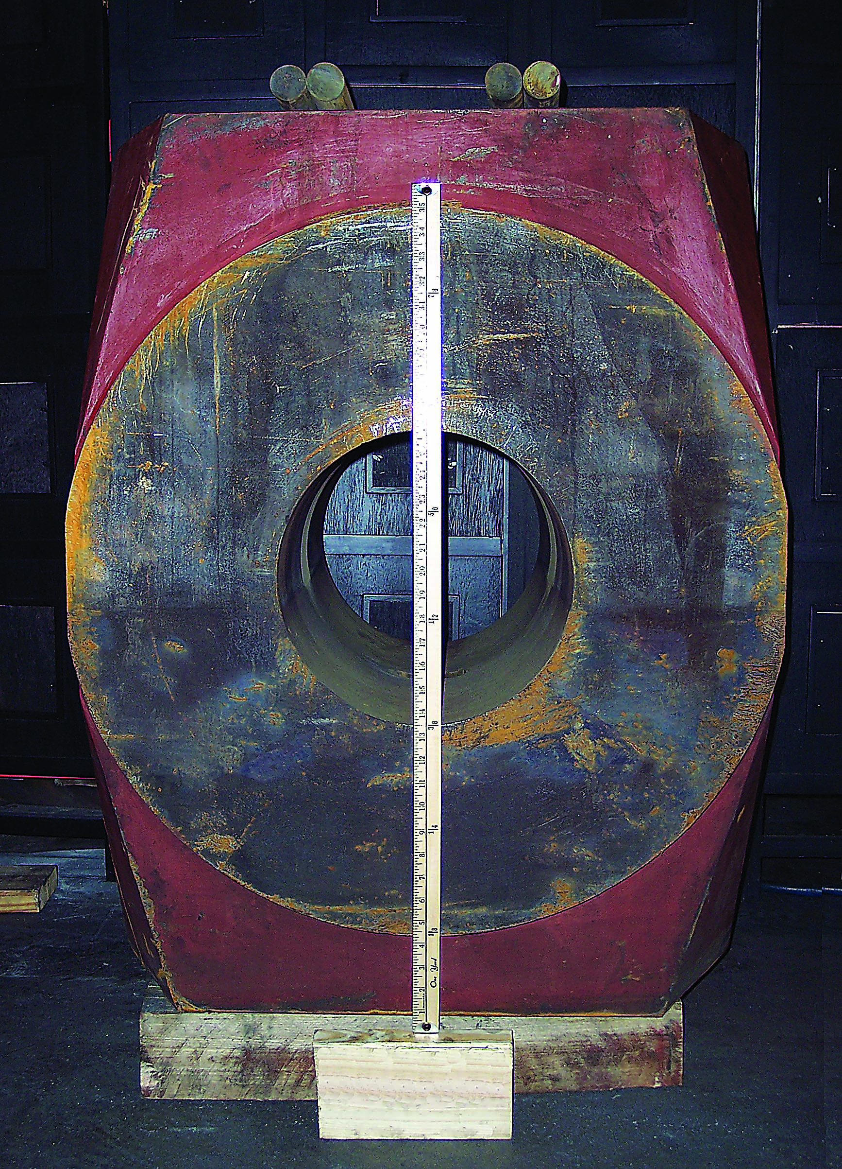

A stepped keyway 4″ wide × 25.5″ long was cut in this 4,900-lb. part using the Ingersoll Gantry 2000 sinker EDM. The 57-ton machine measures 22’×11′ and is 17′ high. The machine stretches another 5′ underground and is supported by a concrete slab 1½’ thick. The tank walls can be raised to allow parts up to 53″ tall to be submerged. When filled, the tank holds 62 oil drums containing 55 gal. each. The table capacity for this machine is 66,000 lbs. All images: Reliable EDM

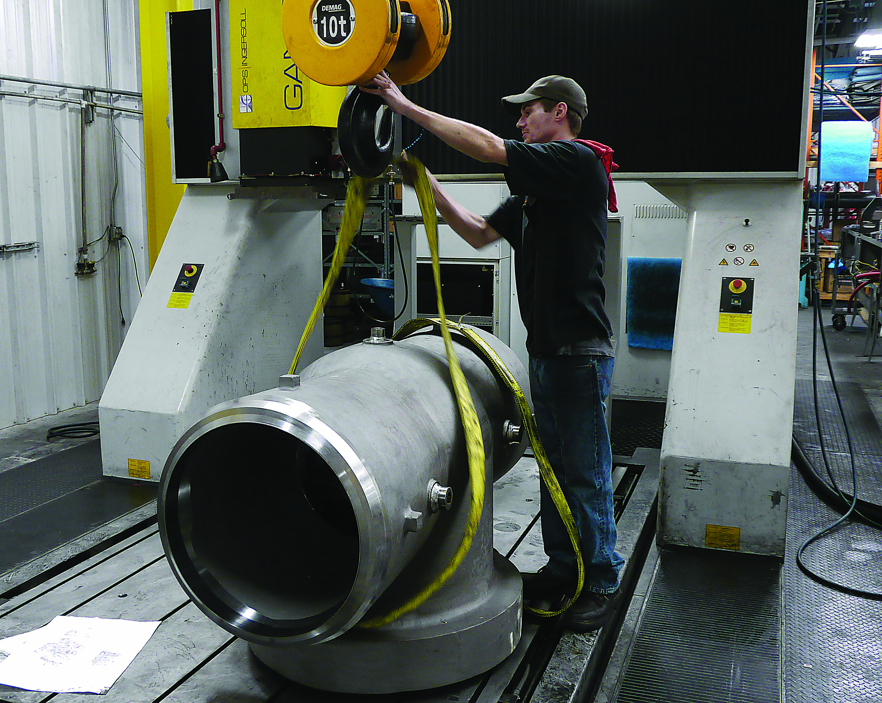

Reliable was able to cut out test specimens from this 40″-tall blowout preventer
using wire EDM. The company can handle parts weighing up to 10,000 lbs.

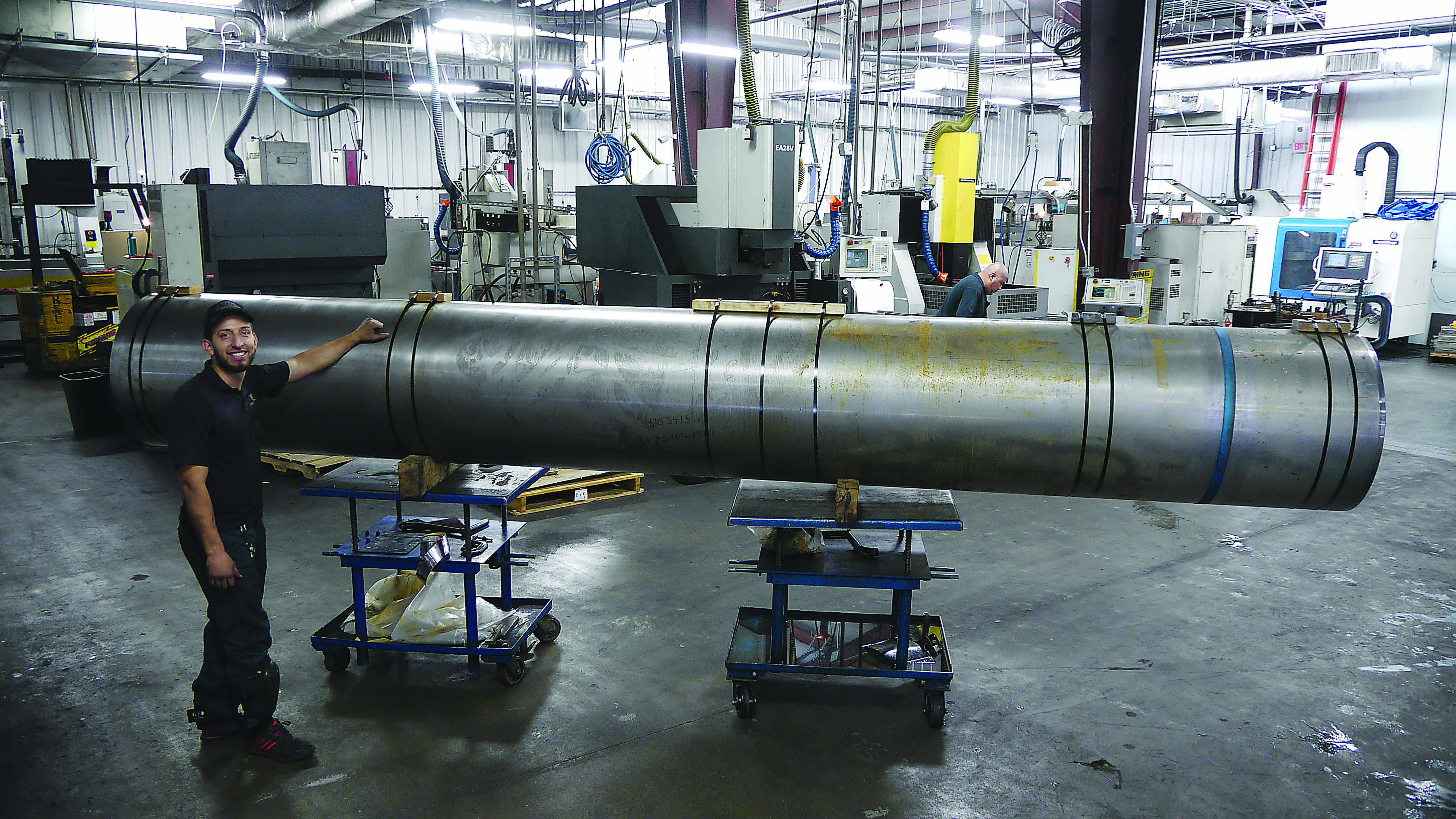

A customer needed this 16′-long, 27″-dia. tube cut in half lengthwise.
The tube was too large for the machine, so Reliable modified a standard wire EDM to machine it.

One of the largest ram projects completed at Reliable was a stepped keyway 4″×25.5″ long in a giant part that weighed 4,900 lbs.

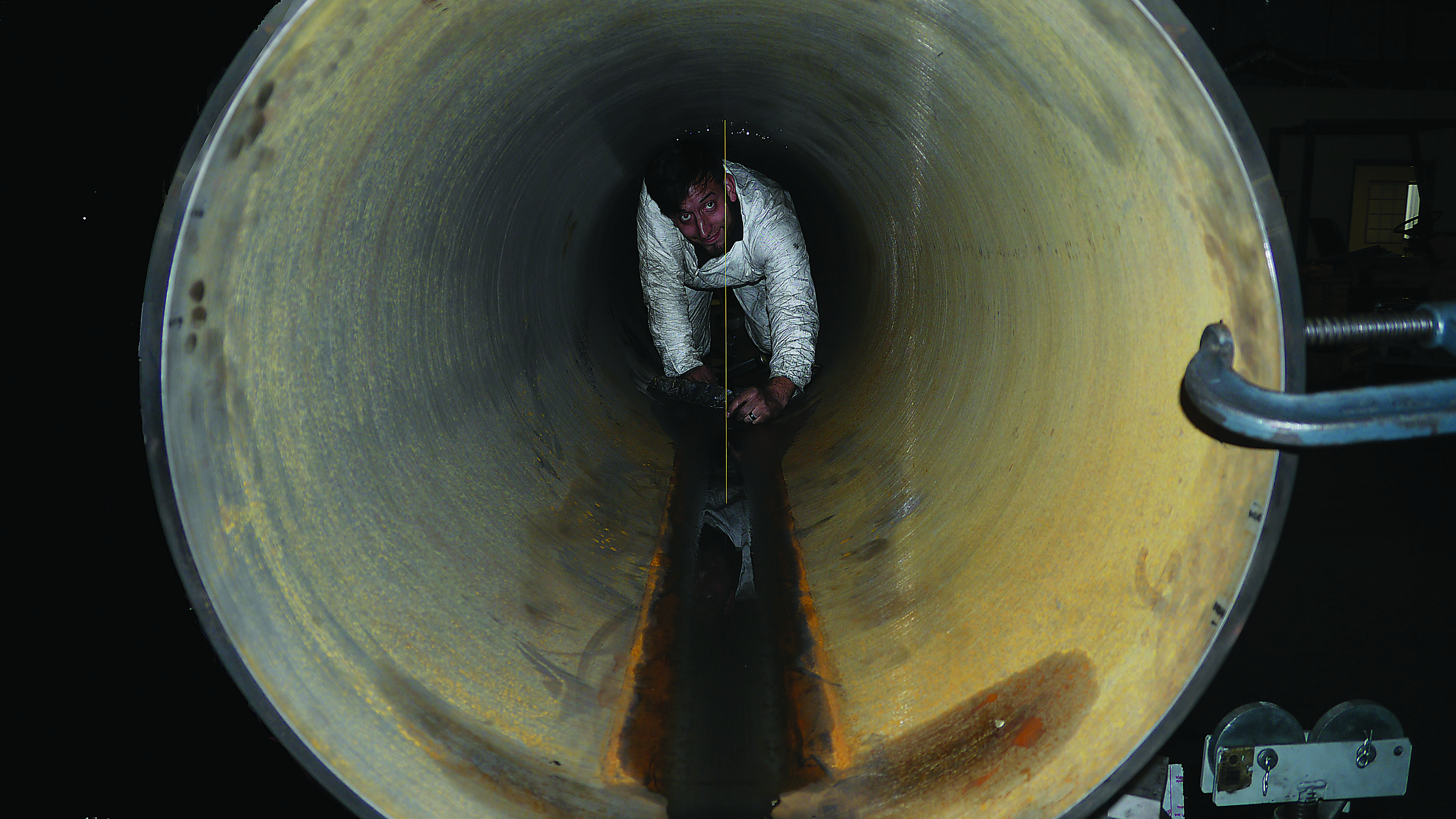

A Reliable employee had to crawl into the tube to thread the wire for the EDM tube-cutting operation.
Tolerances also are more difficult to hold when sinker EDMing some large parts—for example, when submerging the part becomes difficult and it must be extended off the end of a machine. The challenge is holding the electrode steady inside a deep or large part to prevent any vibration. “In those cases, you have to pay special attention to designing the fixtures to do the burn,” Steve said.
Another challenge is setting up a large part for EDMing and aligning it, especially for parts held off the table.
For large parts, referencing a zero-zero point and locating the starting position is tricky, according to Steve. “If you have a big, long pipe and you’re trying to get the inside diameter where you can do the cut, you have to put a probe in there and pick up your part, and that becomes a challenge too.”
