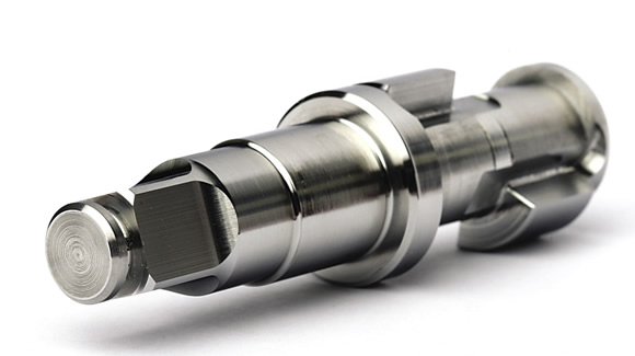

A Nakamura-Tome NTY-3 multitask turning center replaced three traditional machine tools in the manufacture of this spindle shaft. Cycle time was cut in half, to 2¼ minutes, among other benefits.

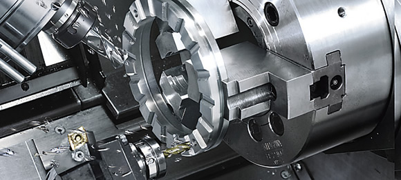

Those operations include pinch milling, where both sides of a thin- walled workpiece are milled simultaneously between the upper and lower spindles on a turn/mill machine, and pinch fixturing, where the lower turret is used as a programmable fixture to support the part. Other operations supported by multitasking include gear cutting, cylindrical grinding and grind hardening, where the workpiece is heat treated in the machine, relying on friction between the workpiece and wheel instead of flame or a furnace. This allows annealed-state machining and then selective surface hardening, followed by finish grinding or hard turning.
“We intentionally do everything wrong in grinding,” Hyatt laughed. “This allows us to generate a precise heat flux. It gives far more control than you can achieve with traditional heat treating. Better yet, it reduces energy consumption by 70 percent compared to traditional surface hardening techniques.”

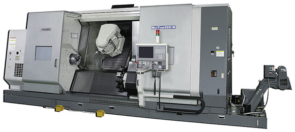

Okuma’s MacTurn 550-W is a multifunction horizontal lathe that improves throughput and virtually eliminates fixturing, according to the builder. The machine has an automatic tool changer, large tool storage, a lower live turret and 9-axis machining/turning capabilities.
