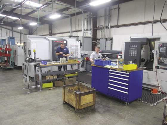

A bar-fed Mori Seiki NL2000SY lathe (right) and a Mori Seiki NL2500SY lathe turn the ODs of gun barrel shafts.

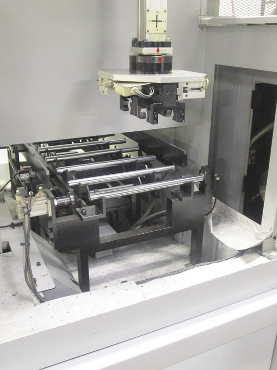

A gantry auto loader on a Mori Seiki NZS1500 lathe turns the ODs of shafts on AK-47 gun barrels.

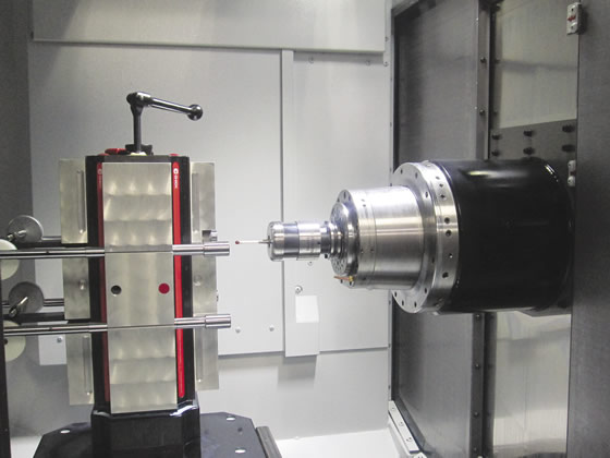

A two-pallet Mori Seiki NHX4000 horizontal machining center mills AK-47 barrels. Each pallet holds four barrels. A Renishaw probe sets offsets for each barrel, updates 64 offsets on each cycle and proves out a ring gage on every other cycle. If the offset varies more than 0.050mm (0.002") from the previous one, the machine alarms and stops.

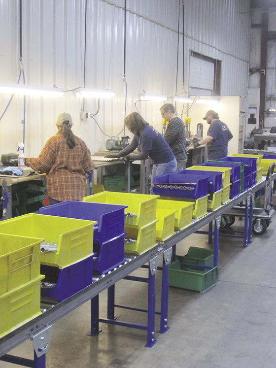

The gun barrel finishing and final inspection line.
Despite the challenge of recruiting new employees, DC Machine’s turnover rate has dropped over the past 18 months, and the staff has consistently met production and ISO 9001quality objectives of less than 2 percent scrap, greater than 95 percent on time delivery, greater than 90 percent customer satisfaction and more than 15 percent sales growth per year. “Every month we get a catered meal,” he said. “We give out $100 gift cards in a raffle every month, and we recently celebrated our 10th anniversary.” The shop offers a full benefits package after 6 months.

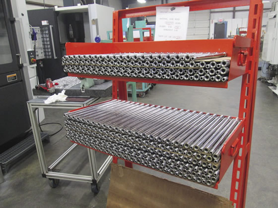

Turned AK-47 barrels ready for the milling operation.
