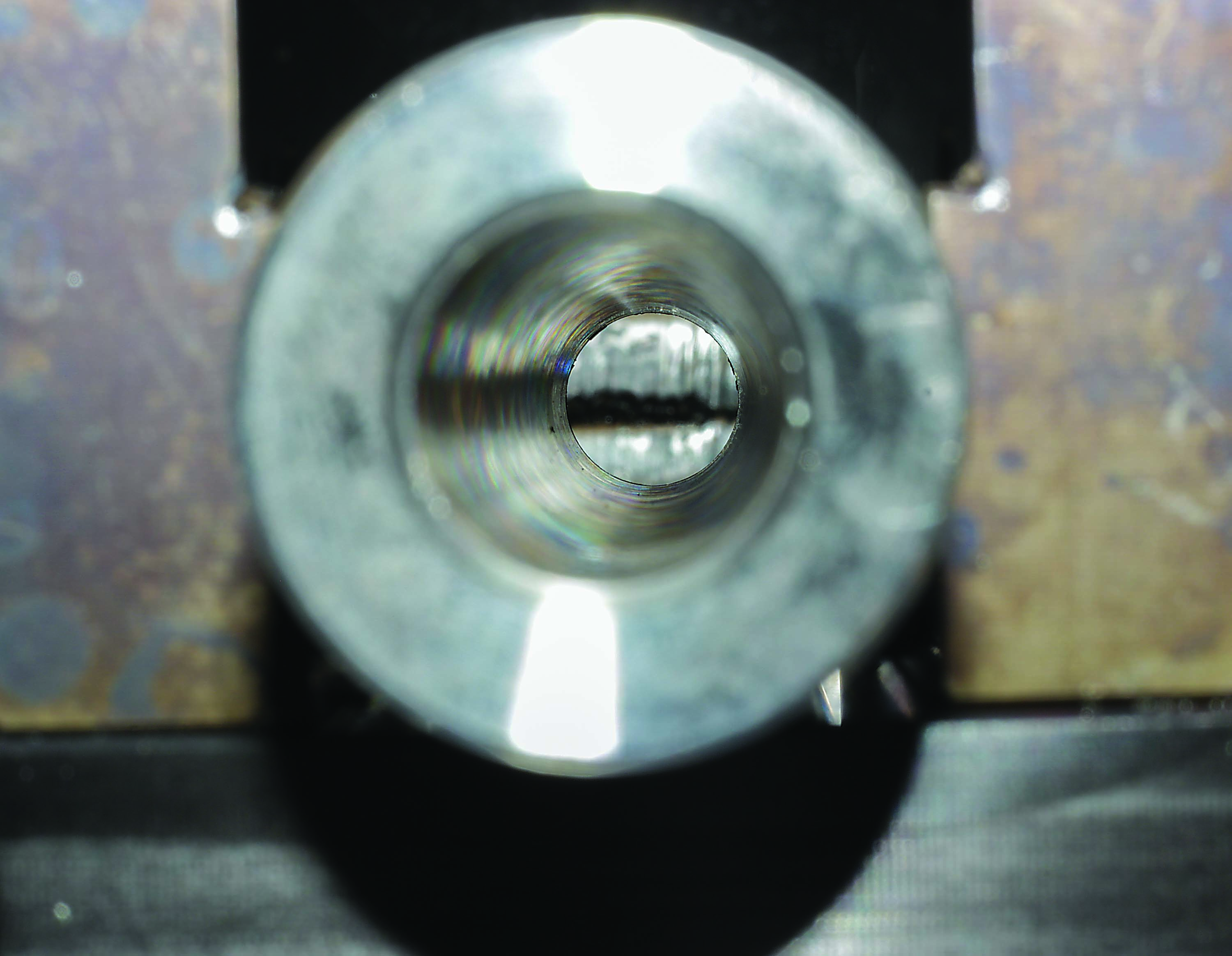

Note the visible perimeter ring created by the initial spot drill and chamfer. Establishing a pilot hole to secure stable entry ensures that the job starts on center. Image courtesy of Allied Machine & Engineering

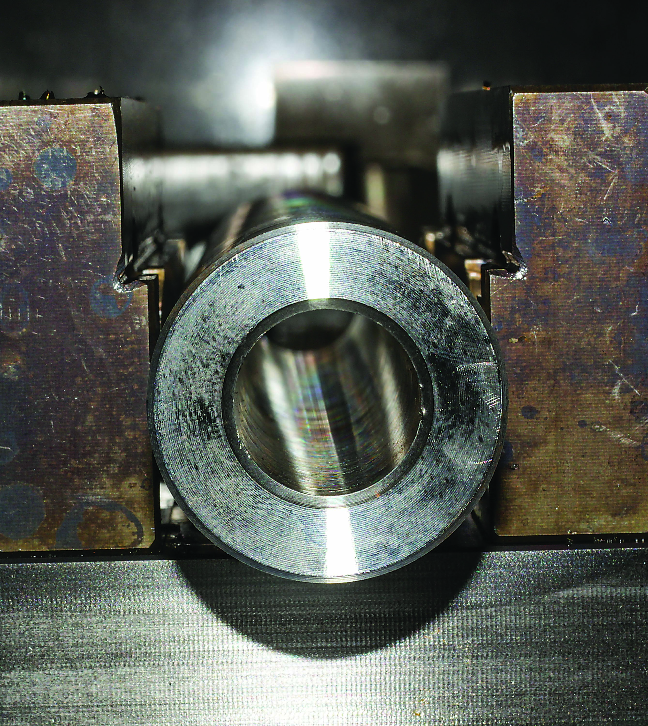

DeLuca: More often than not, we see improper geometry selections being a main contributor to issues. This goes back to understanding your workpiece material and making sure you have the right tool for the job. Some workpiece materials will have a high variance in composition, which can cause the cutting edge to deflect, ruining your chances for a straight hole. Material-specific insert geometry can make a huge improvement. If your tolerance is on the more difficult end, having a guided toolholder is the ideal way to go. Our customers have had really good and much quieter results from our guided T-A drill, nicknamed the stealth drill.

A guided drill with material-specific insert geometry maintains chip control and provides a superior surface finish in this 9" hole through 17-4 stainless steel. Even cutting forces help maintain straightness. Image courtesy of Allied Machine & Engineering

DeLuca: Spot drilling is a common problem but more so in relation to the type of spot drill you use. When it comes to deep-hole drilling, we suggest a stub-length drill to pilot the hole with the same insert that you will be using in the deep drill. This will not only allow the deep drill to settle in quickly—because it has the same included angle—but also provide safety. We do not want a 30-diameters-deep drill whipping in free space. Starting the tool inside of the pilot hole will ensure a better hole but, more importantly, a safer work environment.
