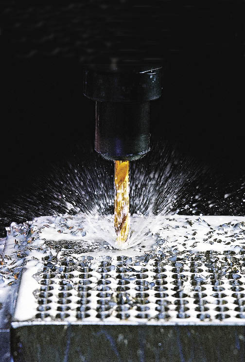

The biggest challenge end users face when drilling superalloys is how best to manage the resulting heat. Two prime considerations are drill coatings and coolants. “Titanium-based tool coatings are used extensively in the machining of superalloys,” said Guhring’s Hellinger. He added that coatings such as “titanium aluminum nitride and aluminum titanium nitride have an oxidation temperature that is over 300° F higher than titanium-nitride coating. These coatings form an amorphous layer of aluminum oxide that imparts greater heat and hardness at elevated temperatures, which are common in superalloy drilling.”
CrownLoc drill bit
Courtesy of Seco Tools
The CrownLoc drills from Seco Tools incorporate exchangeable crowns, which eliminates regrinding.
As for coolants, McCall at Sandvik Coromant prefers water-soluble, vegetable-based ones because they have few chemicals, which minimizes health hazards for machinists. “You also need a high concentration, at least a 10 percent mixture coolant,” he said. “And the other aspect to this, which I don’t think a lot of customers consider, is [through-tool] high-pressure coolant, at least 1,000 psi. The smaller the drill, the less volume you can get through that tool, and that [decreased volume] is the real enemy here. When you have a small drill, the heat at its tip is able to radiate through the entire drill very quickly. With high-pressure coolant, you’re able to dissipate that heat and evacuate the chips quickly and efficiently. You’re also less likely to have chips stick to the drill tip and then drag inside and score the hole.”
McCall added that cooling efforts can quickly go awry when shops use the wrong toolholder for a tool, such as an unsealed ER collet chuck. If there are any leaks in the holder, water will find them.
“As the drill is engaged with the material, the through-coolant holes are partially plugged and so the coolant, under pressure, is going to find the path of least resistance,” said McCall. “That is also why it is critical to have a drill with large enough flutes for effective chip and coolant evacuation, in conjunction with a suitable toolholder and machine [with through-spindle coolant].”
When problems do occur, they can be hard to detect. With coolant splashing everywhere, the operator might easily conclude that everything is as it should be. All the while, though, the drill tip is heating up.
“As a result, you can bind the tool right in the part and either snap it off, or sometimes the drill is strong enough that you could actually just push the material and blow the hole right out,” said McCall. “Then, of course, the part is deviated.”
