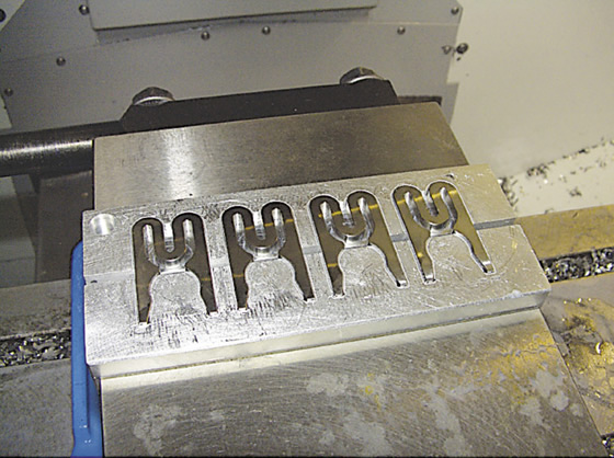

It was a part for the water industry that recently presented him with one of his greatest challenges. “It was a small order, just 100 parts,” Baczynski said. The part was a clip that secured components in a pump assembly for a water filtration system. It measured 1.75 "×1 "×0.1875 " and four clips were cut from a 1.875 "×4.9 "×0.25 " plate.

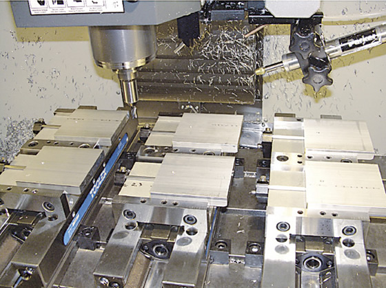

The application actually required two tools: a ½ "-dia. endmill for most of the part and a ¼ "-dia. endmill for finishing and milling areas where the cut had to be stepped down. Neither of those tools made it through the first plate. “I tried other endmills as well but none of them held up,” Baczynski said. “The part was being machined on the Haas Mini Mill. It provided enough speed, horsepower and feed to make it work, but the material itself was exceptionally difficult.”
Image2.tif
Machining 32 clips used in pump assemblies from Super Duplex 2507 destroyed more than 25 endmills before Walter Prototyp tools were used.
Baczynski experimented by adjusting the speed and feed rate and DOC with the various tools, trying multiple combinations. “Even though part thickness was only 0.1875 ", I still had to adjust the DOC to make these endmills last a little longer because the material was proving so difficult,” he said.
So difficult, in fact, that Baczynski destroyed more than 25 endmills to complete just eight plates. The tools wore prematurely and then broke. Long chips led to chip recutting, a situation caused by tool geometry problems and weakness at the endmills’ leading edge. Multiple tool changes and frequent breaks to devise new machining strategies meant the Haas Mini Mill was tied up for 3 weeks while machining the eight plates.

Prater provided two Prototyp Protostar Qmax HR Kordel F40s with a TAX TiAlN coating that stood up to the material. The tool design allows it to cut more freely. Fine serrations on the flutes give the tool superior chipbreaking ability, minimizing chip recutting, according to Walter. This, along with the tool’s stability and the optimized grain structure of the carbide formulation, allow it to work effectively on lower-powered, less-rigid machine tools.
Good Results
The result was immediate and dramatic. “Doing one plate, which is four parts, with the other tools, what with the breakage, replacement and rerunning, was taking me 1½ hours,” Baczynski said. “With the Walter Prototyps, though we had determined that a slightly slower speed and feed rate would be optimal, I was completing a plate in 45 minutes. That was because the Prototyps held up, so no tool change was necessary, and I was able to take a full DOC of 0.1875 ". With the old tools, I had to take multiple shallow cuts to keep them from breaking.”

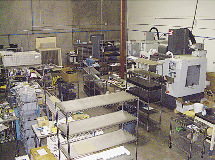

AB CNC operates three machine tools and employs two machinists.
