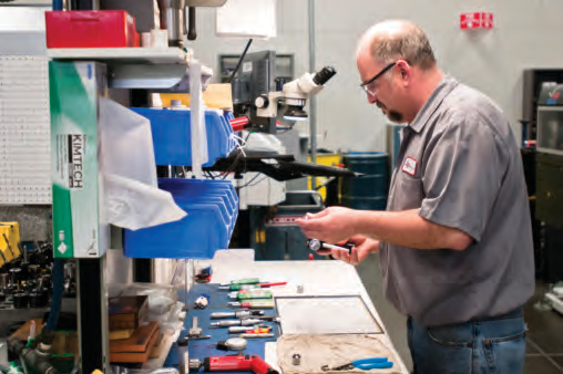

Courtesy of Pointe Precision
Pointe Precision's machine operators have access to a 10× stereo microscope mounted on a swivel arm at every bench.

An example of a larger shop using stereo microscopes is Pointe Precision Inc., Plover, Wis. Founded in 1995, Pointe is a contract machine shop specializing in milling, turning, grinding and heat treating. About 75 percent of Pointe's work is in the aerospace industry, 8 percent is in medical, and the rest is recreational, industrial and commercial.
The company has 2,000 part numbers. The smallest parts measure less than 0.100 " in diameter and the biggest are 28 "×24 "×16 ". A simple part might have three or four features that need inspection but some have 200 or more features.
Pointe's machine operators are responsible for inspecting their parts. They have access to a variety of inspection equipment, including a Unitron 10× stereo microscope mounted on a swivel arm at every bench. "We have additional microscopes that can go up to 30× for visual inspection located throughout the shop," said Sam Crueger, Pointe's director of engineering services.
