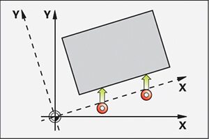

Workpiece alignment
Exact workpiece alignment parallel to the axes is important for workpieces that have been partially machined so that their existing reference surfaces are in an accurately defined position. Touch probes speed up this process exponentially; the workpiece can be clamped in any position, and the probe goes to work analyzing the position and determining any misalignment. The touch probe transmits the data back to the control, which then compensates for the misalignment by rotating the coordinate system or rotating the rotary table.

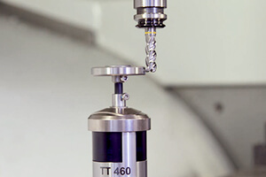

Tool measurement
Consistently high machining accuracy requires an exact measurement of tool data and cyclical inspection of tool wear. Touch probes can measure a variety of tools right on the machine—down to the measurement of individual teeth on a milling cutter, for example. The CNC automatically saves the measured tool data in the tool memory for later use in the part program. Using a cuboid probe contact, you can also measure lathe tools and check them for wear or breakage.

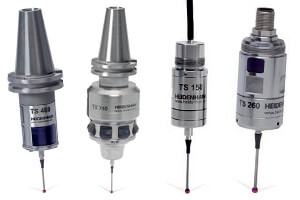

Touch probe for workpiece and tool measurement
Touch probes are available in various types to meet measurement needs for machining centers, milling, boring, reaming, tapping, coun…" title="Operation in which a rotating tool is used to create a round hole in a workpiece. Drilling is normally the first step in machining operations such as boring, reaming, tapping, coun…" aria-label="Glossary: drilling">drilling, and boring machines, as well as on CNC lathes. Here are some things to consider when assessing touch probes for workpiece and tool measurement:
Connectivity
There are touch probes available with wireless signal transmission for machines equipped with automatic tool changers as well as touch probes with cable-bound signal transmission for machines that require manual tool changes.

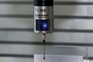

Sensor
Depending on the sensor type, touch probes gather information in different ways. With an optical switch sensor, a lens system collimates the light emitted by an LED and focuses it onto a differential photocell. Upon deflection of the stylus or probe contact, the differential photocell produces a trigger signal. Thanks to the non-contacting optical switch, the sensor remains free of wear. Users enjoy high long-term stability with constant probe repeatability even after a high number of measuring cycles.
Alternately, touch probes with a high-precision pressure sensor employ force analysis. During probing of a workpiece, the stylus is deflected and a force acts on the sensors. The resulting signals are processed and the trigger signal is generated. The relatively low probing forces involved provide high probe accuracy and repeatability, virtually without the characteristics of tactile probing.
