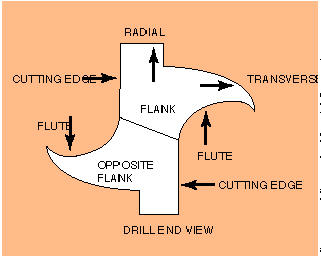

A more detailed analysis of the stresses in the film, the substrate, and the interface between the two was performed using X-ray deflection (XRD). The determination of stresses by XRD is based on classical elasticity theory. For this analysis, the films were step-scanned on WC and diamond with a chromium radiation of 2.2897 angstroms wavelength. The schematic for the stress-measurement points on the drill is shown in Figure 1. The drills were scanned for both WC and diamond diffracting planes. The residual stresses were automatically calculated from the scans.

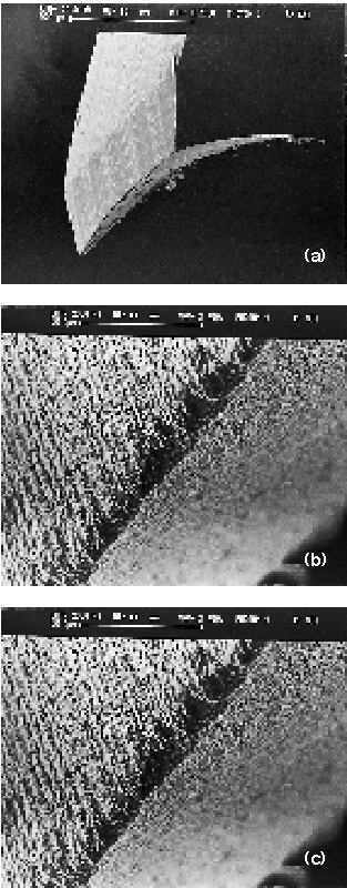

The researchers also examined the drills using a scanning electron microscope (SEM) before and after the coating process. Figures 3a and 3b show the cutting edge at two different magnifications. In both figures, imperfections and gouges can be seen along the edge. Figure 3c is an SEM image of the cutting edge of a drill after it was prepared with the proprietary treatment for cobalt removal. By comparing this image with the image of the cutting edge before treatment in 3b, we can see that the chemical surface treatment produces a porous surface and alters the nature of the flank and flute surfaces.

Figure 1: A schematic of the points on the drill at which stress measurements were taken.

Figure 3: SEM images of the cutting edge of a drill as it was received (a), the same cutting edge at a higher magnification (b), and a cutting edge after it had been treated for cobalt removal (c).
