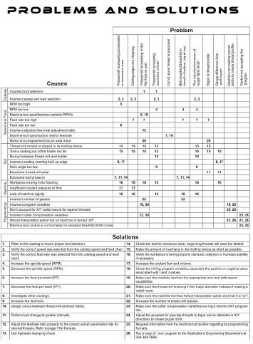

Troubleshooting common thread mill problems
Myles Tool Inc. Co. has compiled a troubleshooting chart listing the 11 the most common problems and solutions for thread milling. Th e four most prominent problems and corresponding solutions are listed below. To view the entire list, visit www.ctemag.com, click on “Machine Operations, Cutting” and scroll down to “Where Taps Fear to Thread.”
1. Thread mill is showing accelerated or excessive wear.
Causes:
a) Incorrect speed and feed selection. Solution: verify the correct speed and feed was selected from the speed and feed chart.
b) Excessive tool pressure. Solutions: Decrease the feed per tooth; perform tool change at quicker intervals; check the tool for excessive wear—beginning threads will wear the fastest.
c) Incorrect coating creating built-up edge. Solutions: Investigate other coatings; increase the coolant fl ow and volume.
d) Spindle speed is too high. Solution: Decrease the spindle speed.
2. Cutting edges are chipping.
Causes:
a) Incorrect speed and feed selection. Solution: Verify the correct speed and feed selection was selected from the speed and feed chart.
b) Th read mill moved or slipped in its holding device. Solution: Use hydraulic clamping chuck.
c) Lack of machine rigidity. Solutions: Verify the workpiece is being properly clamped; retighten or increase stability if needed.
d) Insuffi cient coolant pressure or fl ow. Solution: Increase the coolant fl ow and volume.
3. Steps in thread profile.
Causes:
a) Feed rate is too high. Solution: Decrease the feed rate per tooth.
b) Ramp-in is programmed as an axial move. Solution: Make sure the threadmill is arcing in the major diameter instead of making a radial move.
c) Excessive thread mill wear. Solution: Perform tool change at quicker intervals.
d) Tool is sticking out of the holder too far. Solution: Make the amount of overhang in the holding device as short as possible.
4. Gage difference from part to part.
Causes:
a) Tool is sticking too far out of the holder. Solution: Reduce the overhang in the holding device as much as possible.
b) Incorrect coating creating BUE. Solutions: Investigate other coatings; increase the coolant flow and volume.
d) Workpiece moving in its fixturing. Solution: Verify workpiece is being properly clamped—retighten or increase stability if necessary.
