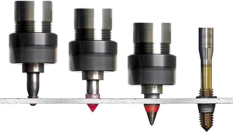

Flowdrill, Baby, Flowdrill
Drilling involves generating chips. It’s just a given—after all, the material that’s removed has to go somewhere, right? But while a process that doesn’t generate chips might not sound like drilling to some, St. Louis-based thermal-friction-drilling specialist Flowdrill Inc. offers an alternative to traditional drilling.
“Thermal-friction drilling is a process that involves generating heat through friction and pressure,” said Mitch Ray, president of Flowdrill. “We create what we refer to as a bushing in thin-walled material, which extends approximately three to four times the original wall thickness.”
This bushing adds more thread to the hole and gives the customer an alternative to current fastener methods like weld nuts or threaded inserts. Once the bushing is created, a form tap can create threads, or a self-threading screw can be inserted to complete the job. There are no chips created in either case.
Flowdrill’s Aludrill geometry is specially designed for use in aluminum. Image courtesy of Flowdrill.
Flowdrill’s Aludrill geometry is specially designed for use in aluminum. Image courtesy Flowdrill.
Every tool bit diameter has a certain set of parameters, Ray explained. For example, a ¼-20 thread size would require a tool to be run at 2,400 rpm in aluminum or mild steel, require 1.5 hp and have a cycle time of about 3 seconds per hole. The bit contacts the material, and the friction of that contact heats the material while the pressure behind the bit pushes through the material and forms the bushing. There is no external heat source, and Flowdrill bits can be used on any standard CNC machine without any special adapters.
The company’s newest geometry is called the Aludrill, which is designed specifically for aluminum.
Thermal-friction drilling creates a hole and a bushing through the use of heat and pressure. Photo credit: Flowdrill
Thermal-friction drilling creates a hole and a bushing—but no chips—through the use of heat and pressure. Image courtesy Flowdrill.
“Unlike our other bits, it doesn’t require our special lubricant; it can operate with standard machine coolant,” Ray said. “It also countersinks a chamfer into the material, which makes it the only one of our bits that generates a chip.”
On a standard Flowdrill bit, a polygon is ground, consisting of four peaks and four valleys, each referred to as “lobes,” which are what generate the friction and cause the heat. The Aludrill eschews this geometry in favor of more contact with the metal, which creates enough friction in the softer aluminum to generate sufficient heat.
“We’ve got some large applications for the Aludrill," Ray said. "Last year, it was used on the new Ford F150 pickup, making holes in the front aprons of those trucks. They use a self-tapping screw to attach the different wiring lines to the front of the trucks."
