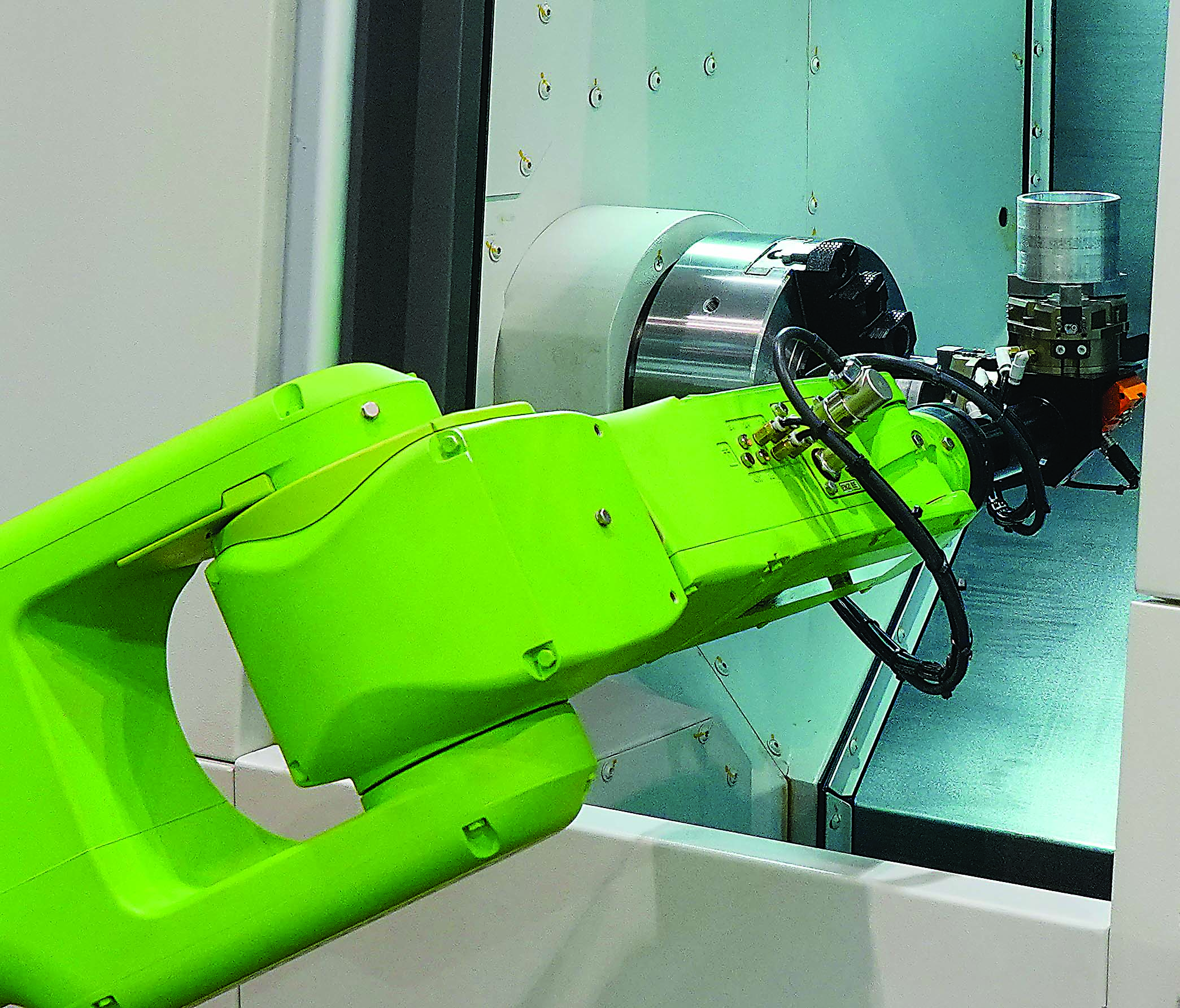

“With a lathe, you’re always loading and unloading to the centerline of the chuck,” said Geoff Dawson, sales director at FANUC America Corp., Rochester Hills, Michigan. “That makes the programming pretty easy no matter what kind of parts you’re working with. Also, the parts are nearly always round, so the end-of-arm tooling is simpler than with some applications. And since the chuck is hydraulically actuated, there’s no need to purchase pneumatic or hydraulic vises like there is on a machining center. The biggest expense—aside from the cost of the robot of course—is adding an automatic door, and some shops will task the robot with this activity as well. Lathes are for the most part robot-ready.”

A FANUC CR-7iA cobot loads a lathe chuck. Image courtesy of FANUC America

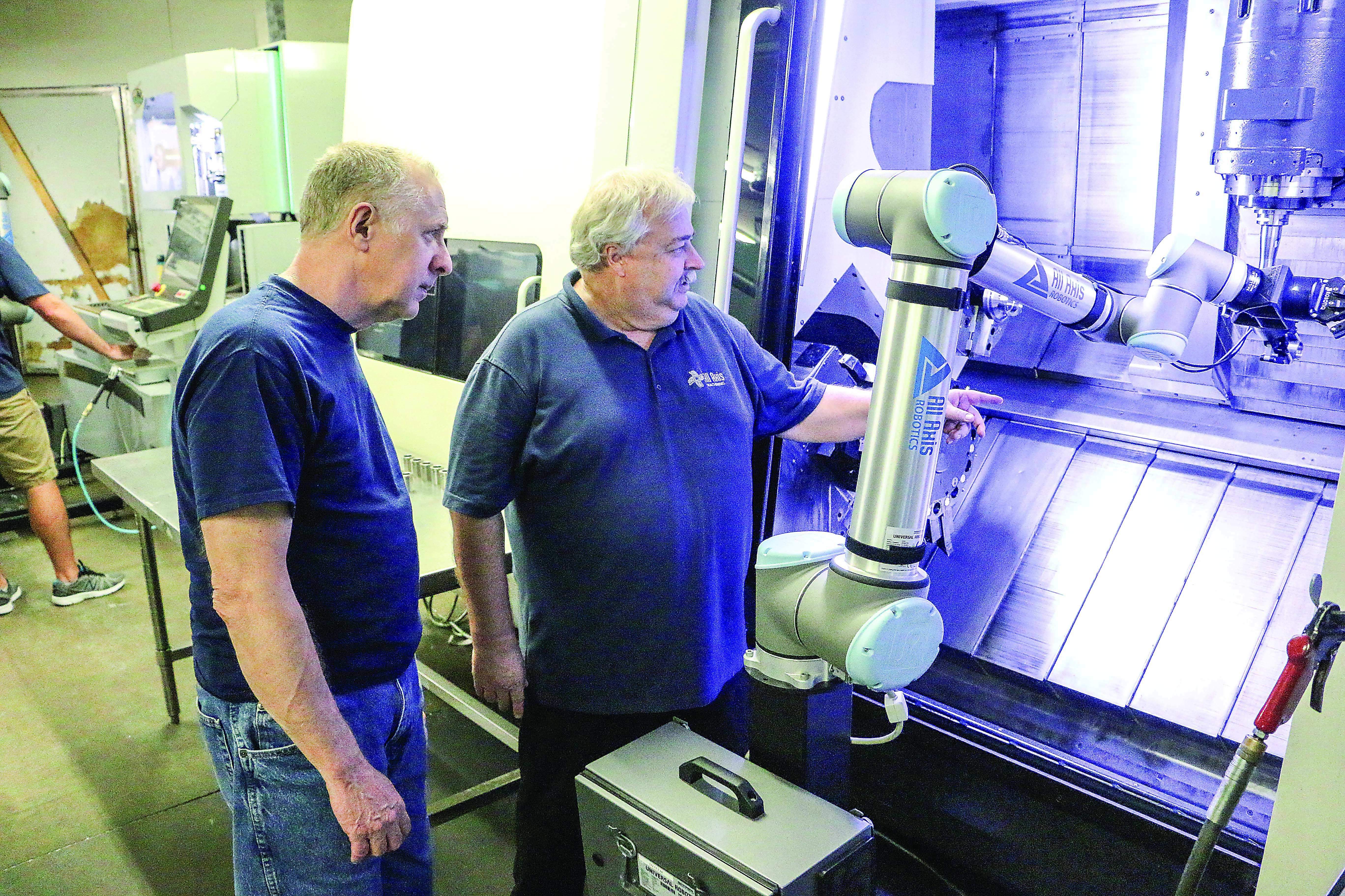

Craig Tomita, target marketing manager at Universal Robots USA Inc., Ann Arbor, Michigan, suggested a different approach, one that also—in most installations—avoids having to install safety guarding.
The open architecture of Universal Robots’ cobot arms enabled Dallas-based All Axis Machining Inc. to quickly automate six different operations, including lathe tending. Image courtesy of Universal Robots USA
“Collaborative robots were labeled as a fad when they first emerged a little more than a decade ago,” he said. “Since then, we’ve proven ourselves as a viable alternative to so-called industrial robots for a variety of reasons.”
He shared several examples of the benefits of cobots:
- Because cobots can be “taught” what to do, a barrier to entry for many manufacturers—complicated programming—has been removed.
- Within minutes, a cobot can be moved to a different location or taught how to do a different job.
- Provided that proper safety assessments have been done, cobots can work alongside humans without guarding.
- Cobots can operate on either 220v, three-phase power or 110v, single-phase power.
- A cobot can be used to tend a lathe, apply glue, install screws, inspect parts and do many other tasks.
“Add it all up,” Tomita said, “and it’s an ideal solution for a lot of shops but especially for small to medium-sized manufacturers or those new to automation.”
