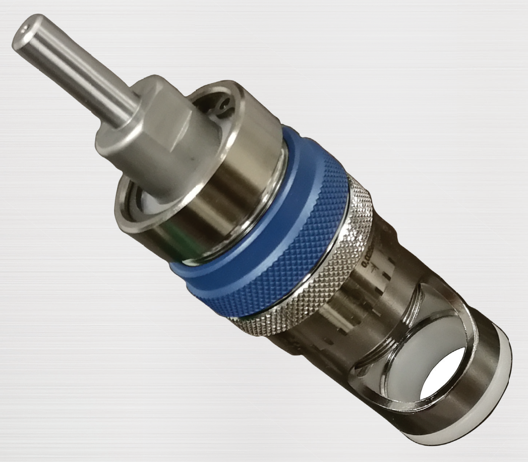

The most common method of countersinking in aerospace applications is with a spring-loaded microstop. Image courtesy of OSG USA

“Several methodologies exist, but the most prevalent is the use of a power drill and spring-loaded microstop, also known as a microcage,” said Linn Win, senior business development manager at OSG USA Inc., Irving, Texas. “The cutting tool itself is typically a piloted 100° or 130° countersink with a threaded shank that screws into the microstop. You set it to the desired depth, place the tool’s pilot into a pre-drilled hole, engage the drill motor and then push down to produce the countersink.”
He described a few methods that are more productive. One is to use a semi-automated drilling unit, which can drill and countersink in a single-shot operation. Also, robotic and fully automated systems not only accurately countersink a hole but install a rivet, commonly known as drill and fill.
Whatever the method, a backing bar or similar type of support — usually placed on the inside of an aircraft — often is needed to keep aircraft skin from deflecting during drilling. In other instances, two or more sections of material may need to be disassembled, cleaned, deburred and then reassembled before rivet installation. Compared with chamfering a hole in a machined part, countersinking fasteners on an aircraft fuselage is complex work.

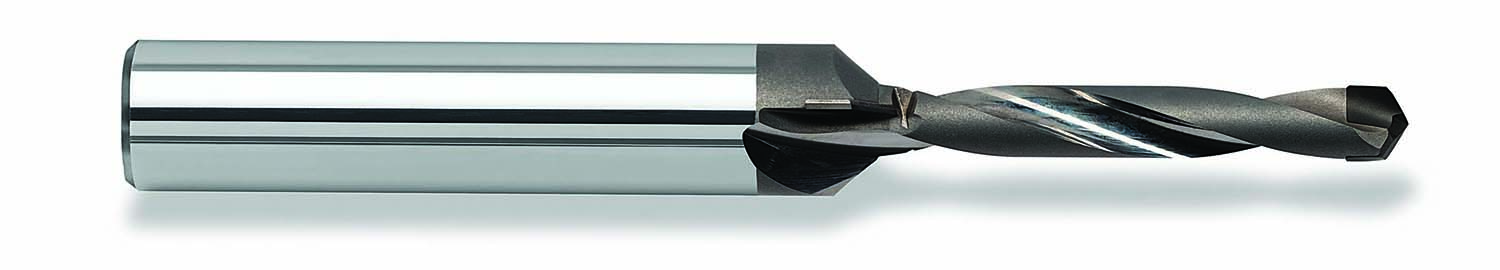

This PCD-tipped, diamond-coated combination drill and countersink is designed for carbon-fiber-reinforced polymer applications. Image courtesy of Amamco Tool & Supply

Gary Rozema, vice president of sales at Amamco Tool & Supply Co. Inc., Duncan, South Carolina, said PCD is the preferred choice for countersinking composite components. That’s because PCD tools generally hold their sharp ground cutting edges longer than tools made of other materials thanks to PCD’s molecular structure and its ability to withstand heat in the cutting zone. Therefore, PCD tools cut cleaner and with less delamination, which are important considerations when cutting any composite.
Tool geometry is also a factor when prepping a rivet hole. He said some fasteners — Hi-Loks, for example — call for a slight radius at the transition point where a drill meets a countersink. This creates a relief that reduces stress on a fastener, hopefully eliminating the possibility of its head popping off in flight.
“This is less of a concern on composite structures as these provide a little more give than with a metal-on-metal connection,” Rozema said. “In either instance, however, the radius also helps assure that the head will sit perfectly flush with the fuselage surface, something that’s crucial to its laminar flow.”
