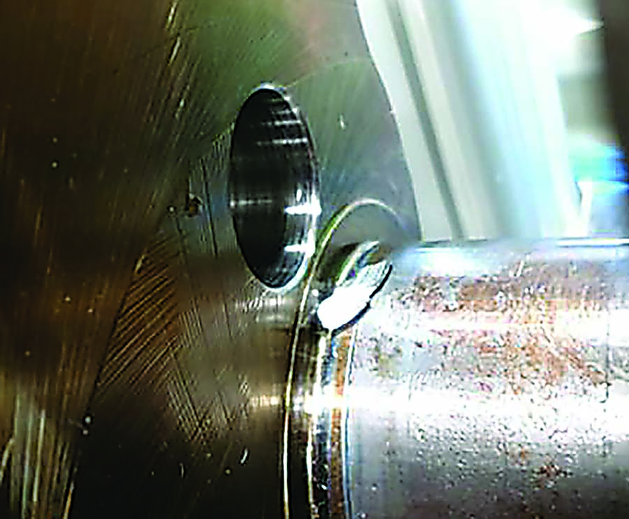

This manufacturer needed to deburr its V-8 crankshafts that consist of a main bore that breaks out into seven different surfaces, some of which are angled/irregular cast surfaces. Image courtesy of Heule Tool
“Cross-hole deburring is an issue for our customers because typically they have to take the part off the machine and remove that burr by hand, which takes a lot of time and actually can cause physical stress for a machinist to do the tedious labor of deburring,” said Lynn Bissell, sales and marketing coordinator at Heule Tool Corp., Loveland, Ohio. “Automated deburring with a tool in the CNC machine provides a solution that makes the process more efficient and gives the end product a more consistent finish from part to part.”

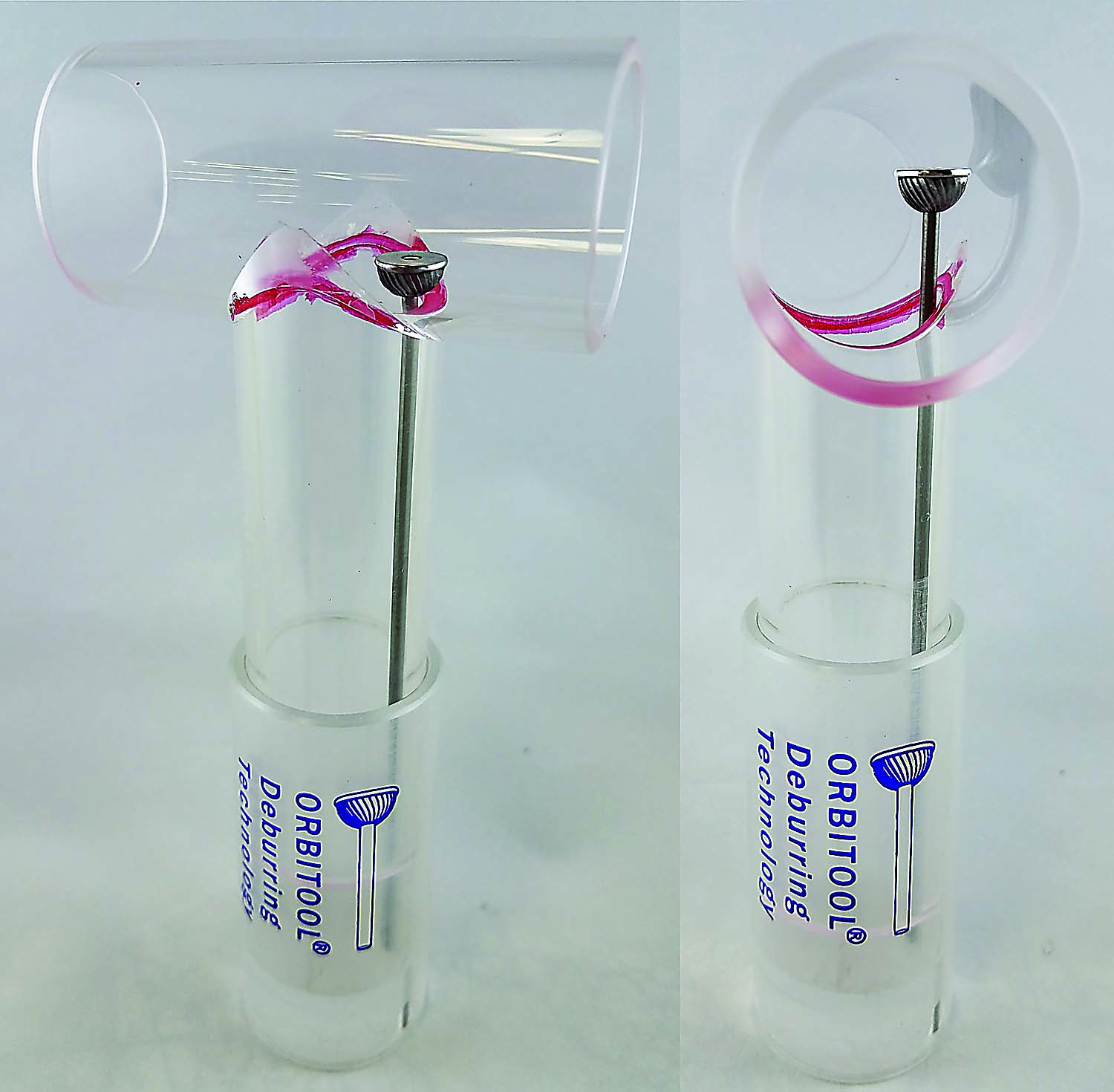

The Orbitool by J.W. Done is used just like any cutting tool found on a lathe turret or tool magazine of a milling machine. The operation removes burrs from the intersection of cross-holes and can be tailored to leave a minimally broken edge or a blended radius. Image courtesy of J.W. Done
“It’s a unique tool that is simple to use,” Hargrove said. “It’s just straight through the center of the hole and straight back out through the center of the hole. It does not need a complex program to follow the contour, because the blade does all of the work.”

Another solution to the potato chip problem is J.W. Done’s Orbitool. Kroll said it was developed to remove burrs from the intersections of cross-holes of nearly or exactly the same size—sometimes called 1-1 cross-holes—such as those seen at the 90° elbow of T-pipes common in fittings and manifolds.
As the diameters of the two holes reach identical size, the potato chip shape expands until the intersection reaches halfway up the sides of both holes. This configuration is typical yet extremely difficult or even impossible for many deburring tools.
“A lot of traditional tools always had a hole ratio limitation,” Kroll said. “They could do cross-holes but only up to a certain cross-hole size in relation to the bore.”
The Orbitool looks like a traditional carbide rotary bur, which is essentially a ball-shaped milling cutter mounted on a rigid shaft.
The difference is the combination of a flexible shaft and a protective metal ring, or disc, which encircles the end of the tool. Kroll said the ring makes it physically impossible for the carbide cutting tool to touch anything but the actual edge of the holes’ intersection, thereby protecting the rest of the part from any stray damage.
“Then the most important thing about our tool is what we call a helical interpolation, which in simple terms is a thread spiral,” Kroll said. “Just as if you were programming a standard thread milling routine with the CAM cycle in a CNC machine, you program the tool to interpolate and gradually feed down the hole towards the edge, essentially tracing the ID of that hole. It’ll constantly flex and adjust and move out of the way if it encounters anything that should be protected. But during that process, it’s going to remove the burrs from all of those edges.”

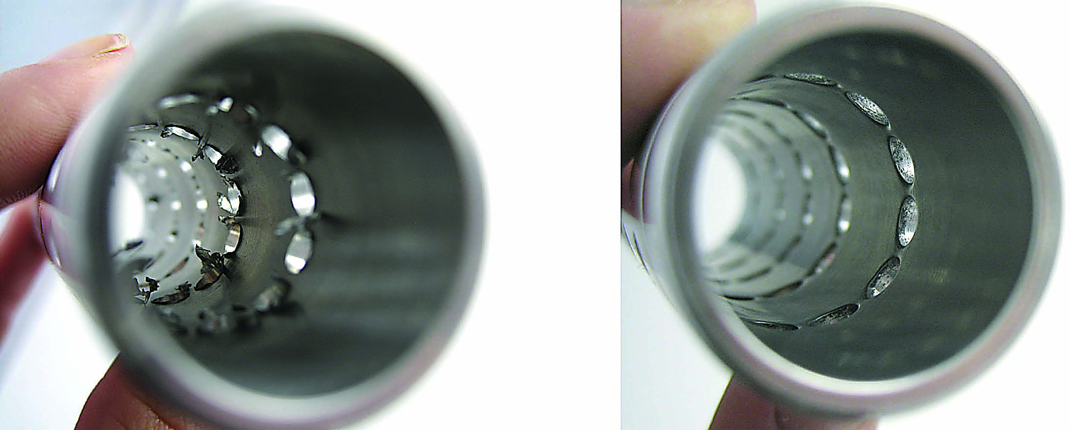

Before and after deburring multiple cross-holes in a bore using the Flex-Hone Tool. Image courtesy of Brush Research Manufacturing
Brushes are especially good at deburring nonstandard shapes and surfaces.
“Because the tool is flexible, angles are not such a big deal,” Cole said. “In the case where a cross-hole breaks into a bore at an angle, as long as the brush can go through the cylindrical main ID, it will deburr the sharp edges and produce a slight radius on that elliptical hole.”
