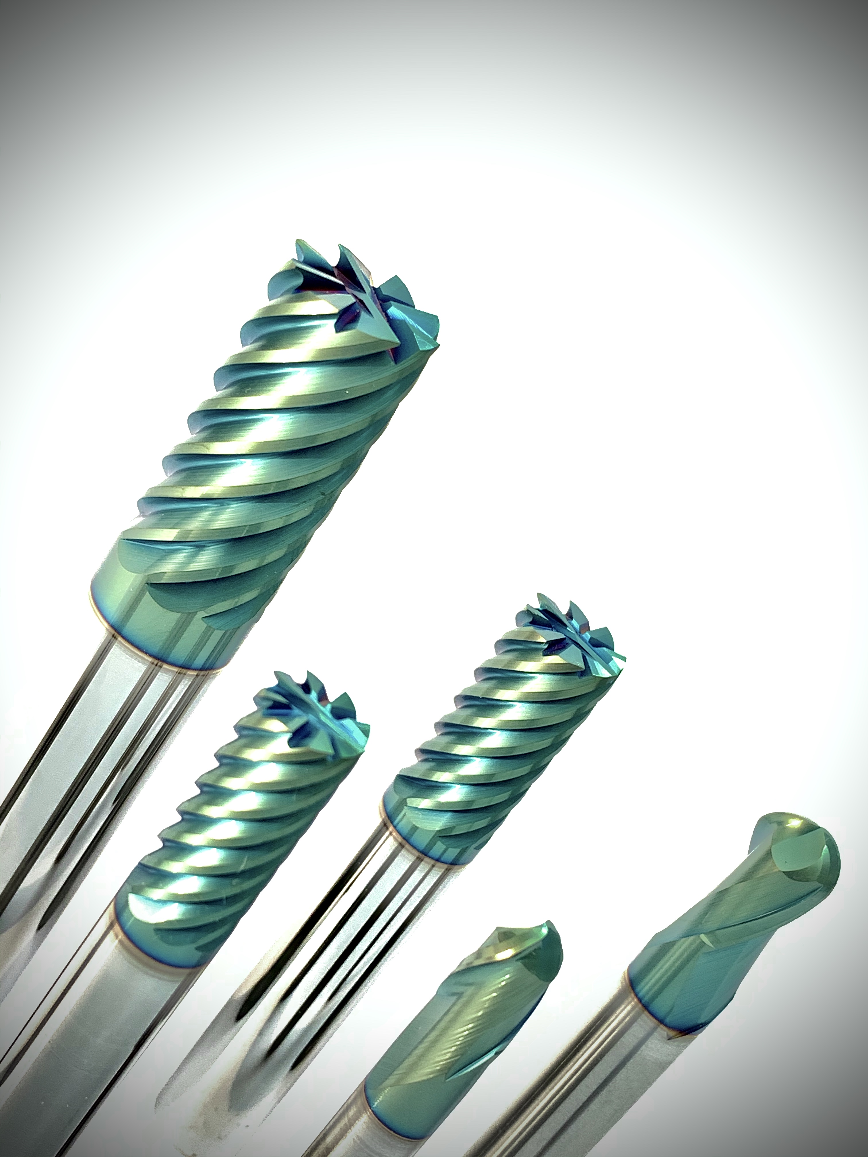

Tool manufacturers can specify special coating colors to distinguish products. Image courtesy of PD2i
“All the new alloys like Inconel and titanium are superlight, but they’re getting harder and harder to cut,” Sheth said. “So the whole coating industry is getting much more niche, more high-tech while at the same time it’s becoming more accessible for manufacturers to get that technology in-house.”

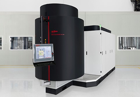

Coating equipment companies offer modular solutions to accommodate different types of coatings for a manufacturer’s specific tool lines. Image courtesy of Oerlikon Balzers Coating USA

Coatings also may add an attractive, shiny appearance and offer options for differentiation and identification.
“Some customers ask us for a standard coating like aluminum chromium nitride, but they want a dedicated color, such as purple or green, for marketing purposes,” said Dirk Haack, CEO of PD2i Europe GmbH, Düren, Germany. “It should look different than the coatings of other companies even if the performance is the same.”
