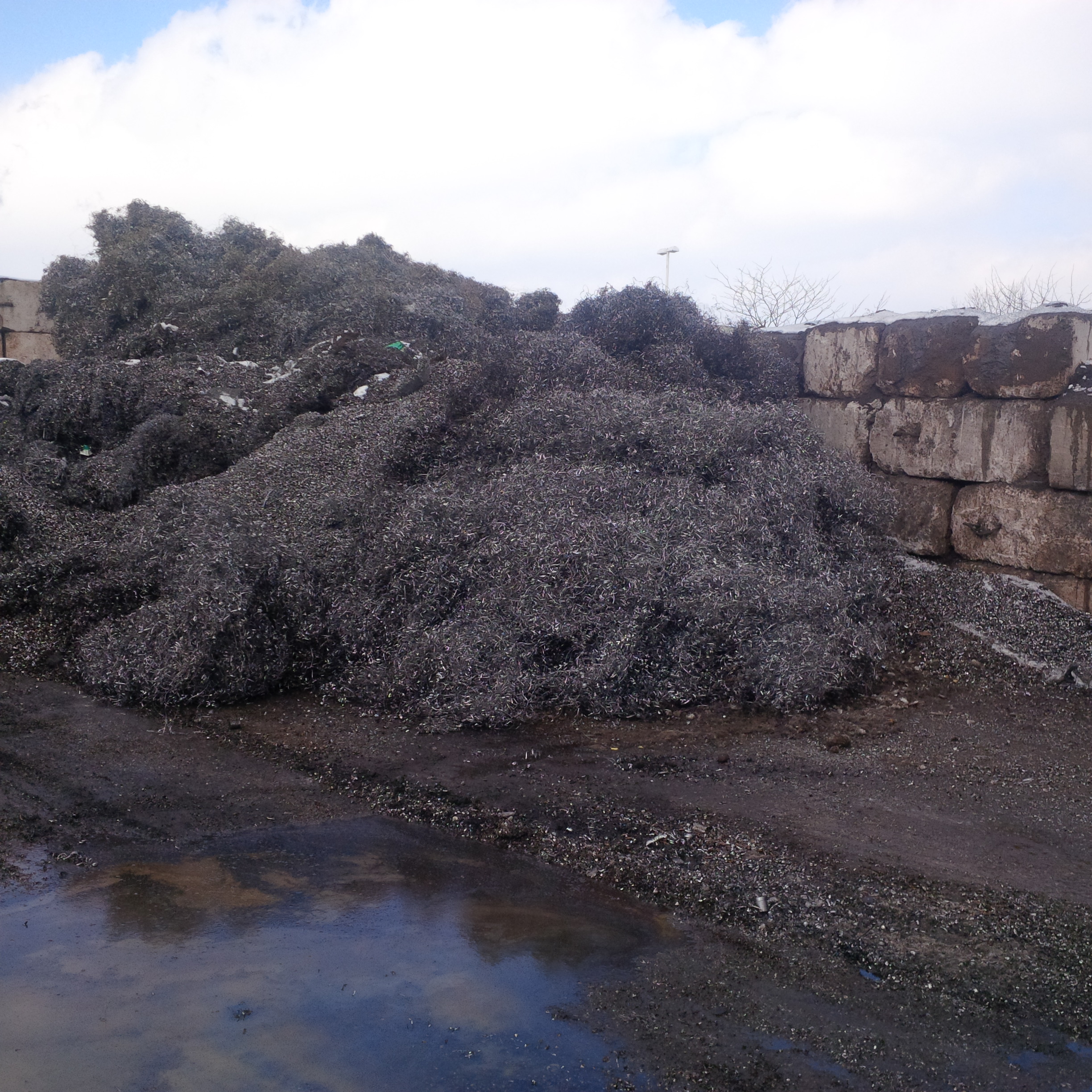

Metal waste such as swarf, shavings, and grinding fines can also be hazardous depending on the type of metal and cooling lubricant used.

The dryer the metal scrap, the higher it’s value to recyclers. In some cases, metalworking operations can receive up to 25% more for dry metal scrap than scrap that is still coated in fluid. Utilizing processes that separate and reduce the volume of scrap material and cutting fluid also helps keep facilities clean because it reduces the amount of space and containers needed for storage on the plant floor.

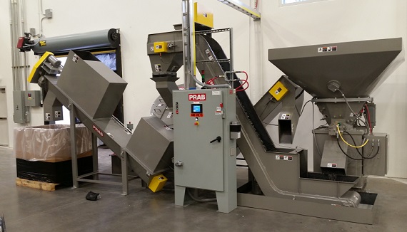

  • Wringers and industrial centrifuges utilize centrifugal force to spin fluid and remove moisture from metal chips. This allows for up to 98% reclamation of cutting fluid that can then be recycled and reused to reduce the need and added expense of buying replacement fluid. A variety of metals including aluminum, brass, cast iron, steel, and stainless steel can be processed using this equipment.
  • Crushers help to reduce the volume of large bundles of metal turnings into flowable, thumbnail-size chips. Crushers can be used as stand-alone units or as part of a larger system with either horizontal or vertical orientation.
  • Shredders make it easy to turn light-to-moderate metal turnings into flowable chips and can be applied to reduce the volume of metal turnings by up to 4 times, further increasing the metal scrap value for the recycler.
  • Tramp metal separators protect the above-mentioned process equipment from damage by removing bar-ends, broken tooling, and other metal solids from chip flow.

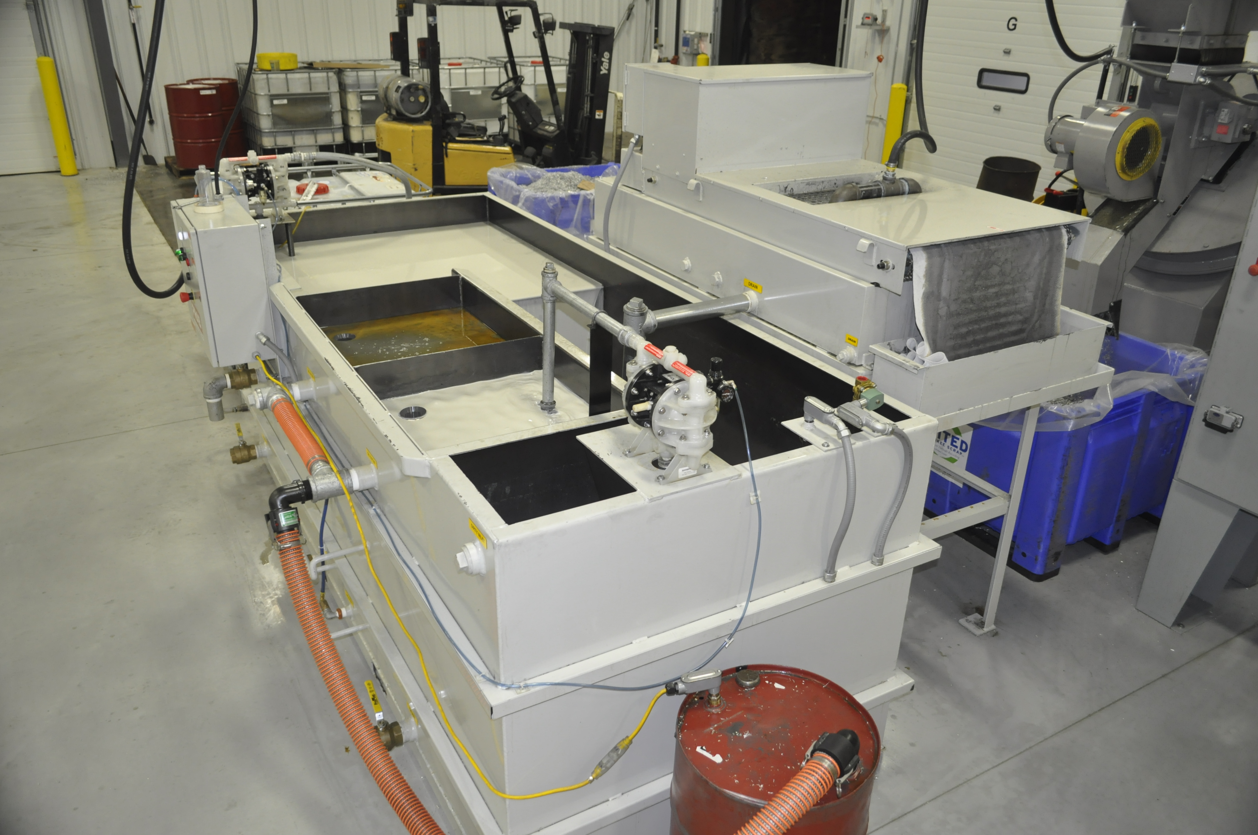

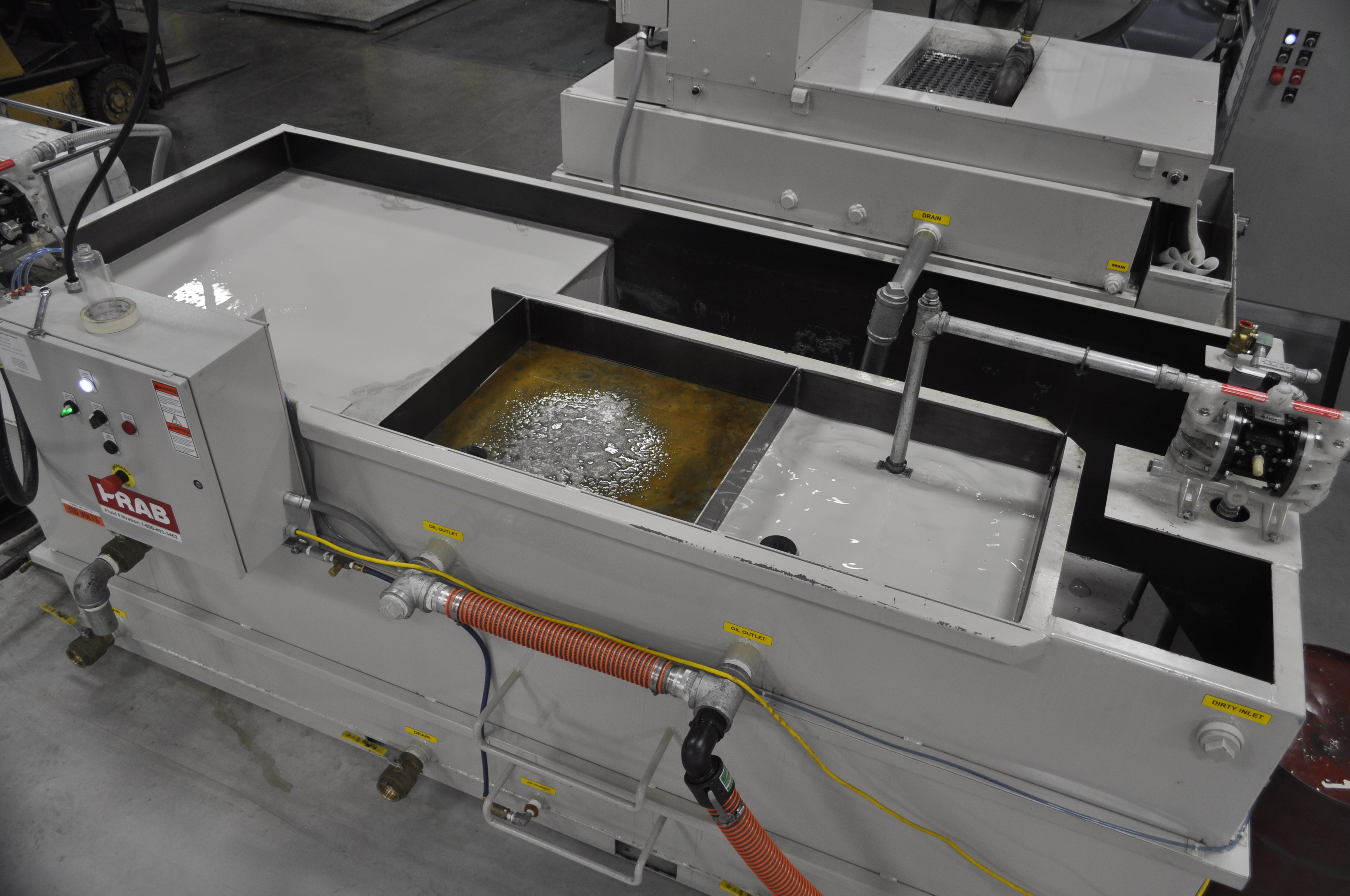

Guardian Coolant recyclingAnother tactic that can be employed to better manage hazardous fluid is through fluid filtration equipment. These systems can reduce hazardous waste volumes by as much as 90% and lower new fluicd purchases by 75%. Employee health and safety can also be improved by keeping bacteria levels in cutting fluid low, which can help prevent dermatitis.
Types of equipment include centralized coolant recycling systems automatically recycle used coolants, reducing waste fluids by up to 90%. These systems can also remove free-floating tramp oils to .1% or less, eliminating concerns about wastewater haul-away liabilities and minimizing exposure to lubricants that can cause health problems.
Tramp oil separators can cut coolant purchases by up to 75% by extending the life of soluble oils, coolant, and washwater. Tramp oil separators automatically remove tramp oils, bacteria, slime, inverted emulsions, and more from individual machine sumps, central systems and wash tanks.
