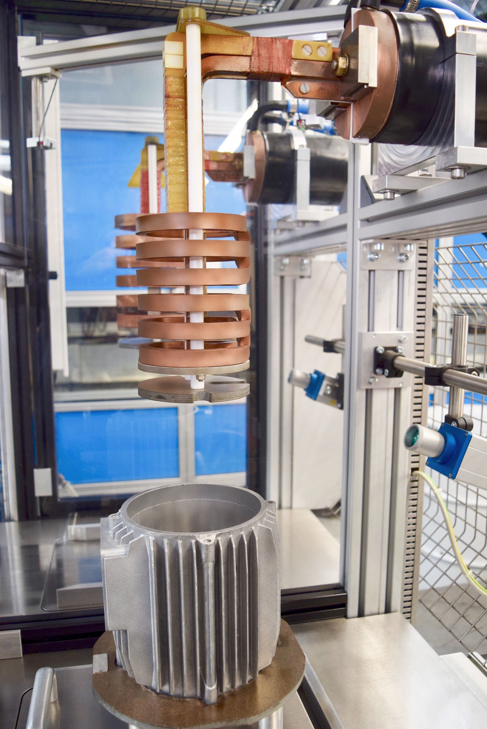

After starting, the component is lifted and encloses the inductor when it reaches its processing position.

In this process, thermal joining of the empty stator housing and motor winding is one of the core processes: The housing is heated to a temperature of 280 to 300 degrees Celsius (536 to 572 degrees Fahrenheit) using an induction heating system. This causes it to expand allowing the motor winding to be inserted by hand. As it cools down, the housing contracts again and establishes a form-fitting and solid bond with the winding. In 2018, the specialists at Elektror decided it was time to replace the aging heating system.

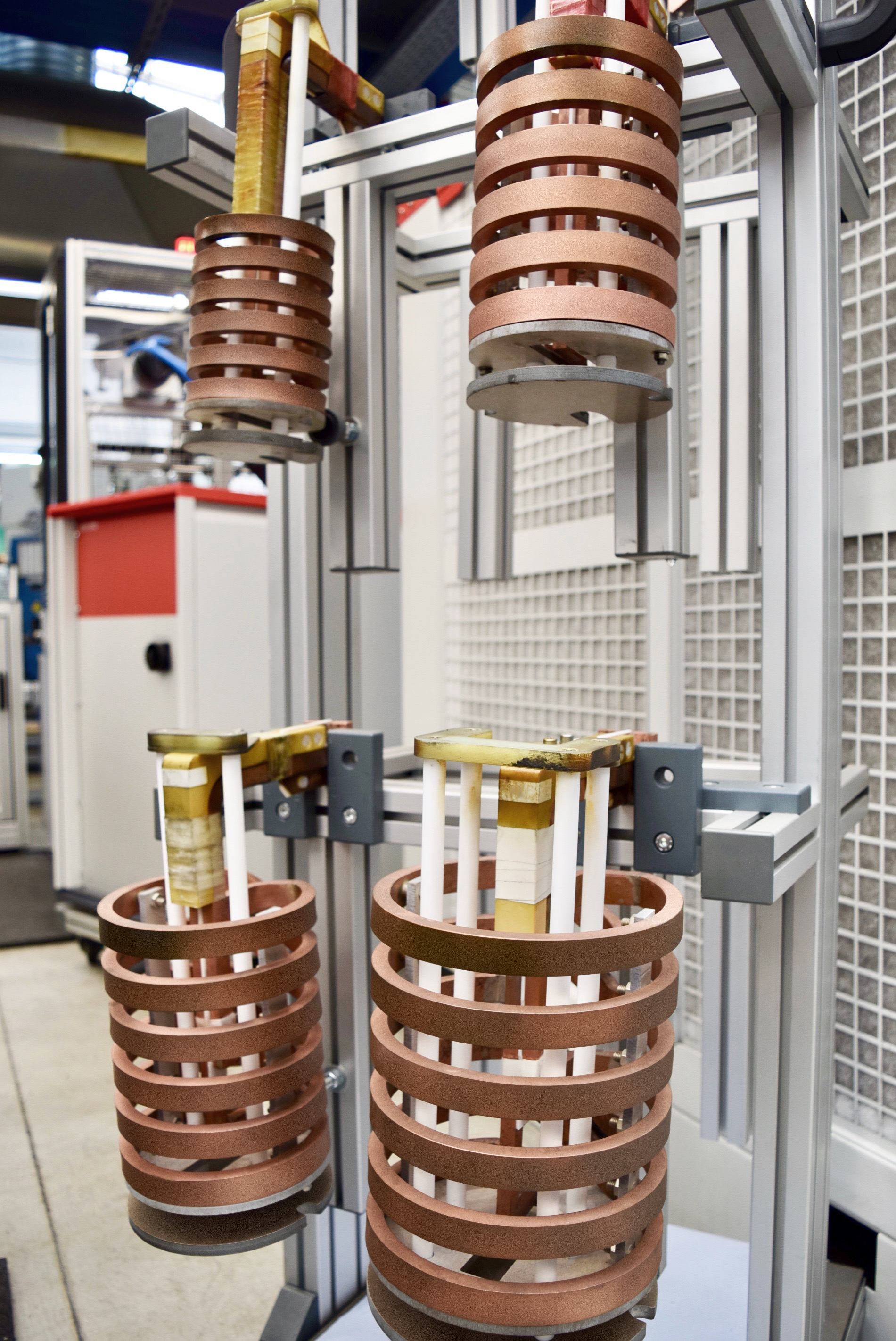

The component sizes change on a regular basis. That is why the UNI HEAT is easy to retool. Elektror has various sizes of inductors available for the empty stator housings.

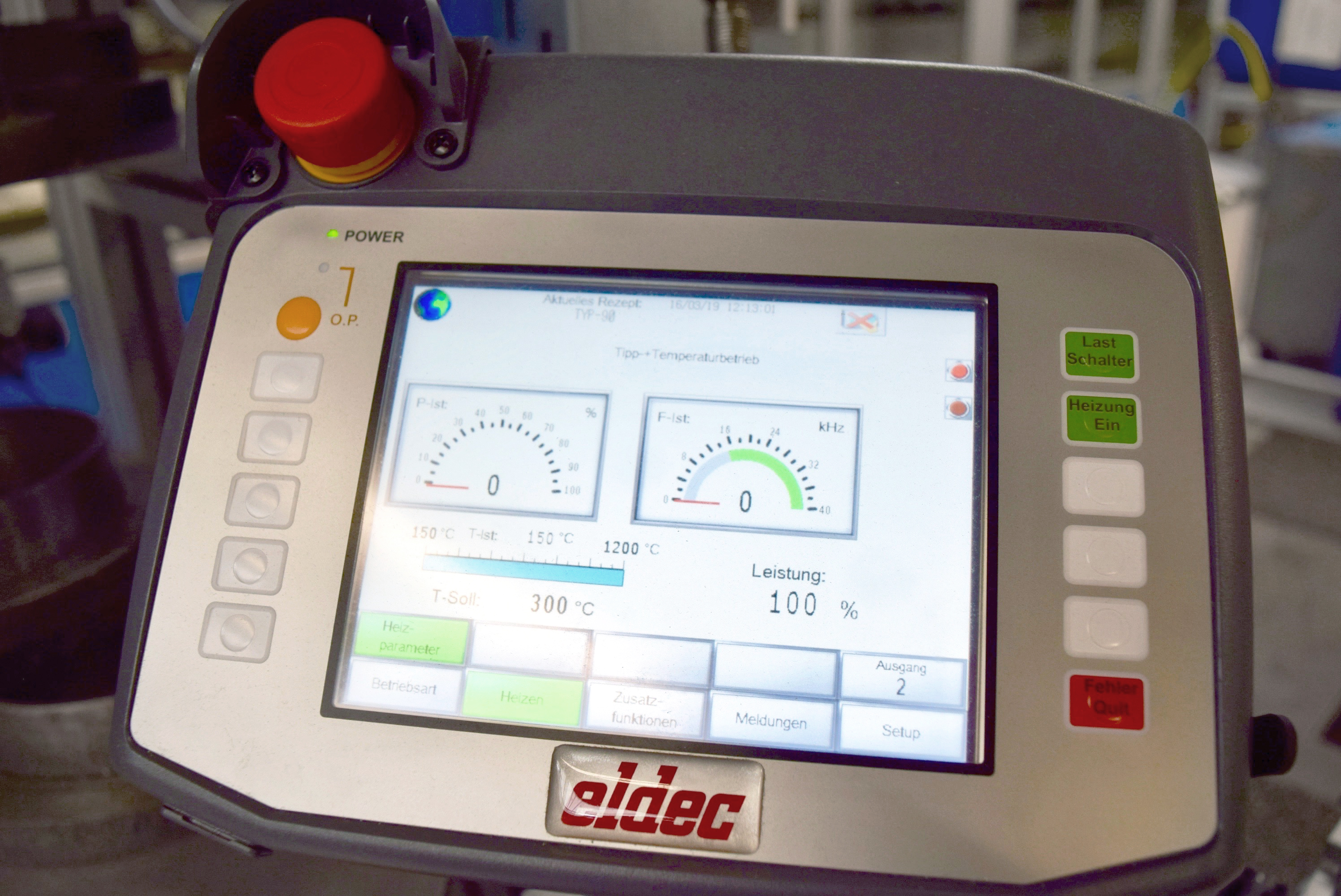

Among others, the UNI HEAT's control unit displays the component's actual temperature during the heating process.

Development at EMAG eldec plays a decisive role for the quality, safety and efficiency of this induction heating process: The induction specialists take responsibility for complete solutions, including the appropriate generator and the required inductors. EMAG eldec is ideally positioned to develop these core elements of a heating process: Firstly, a range of generators with high efficiency and precise application of energy are produced at the site in Dornstetten. Secondly, the specialists produce up to 1,000 inductors per year. They are produced within the scope of a sophisticated manufacturing process that hinges on many tiny details. Critical factors include, for example, how deep and where the heat needs to penetrate into the component. That affects the shape of the inductor and the configuration of the generator.
