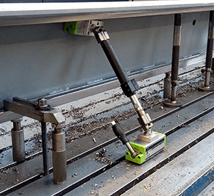

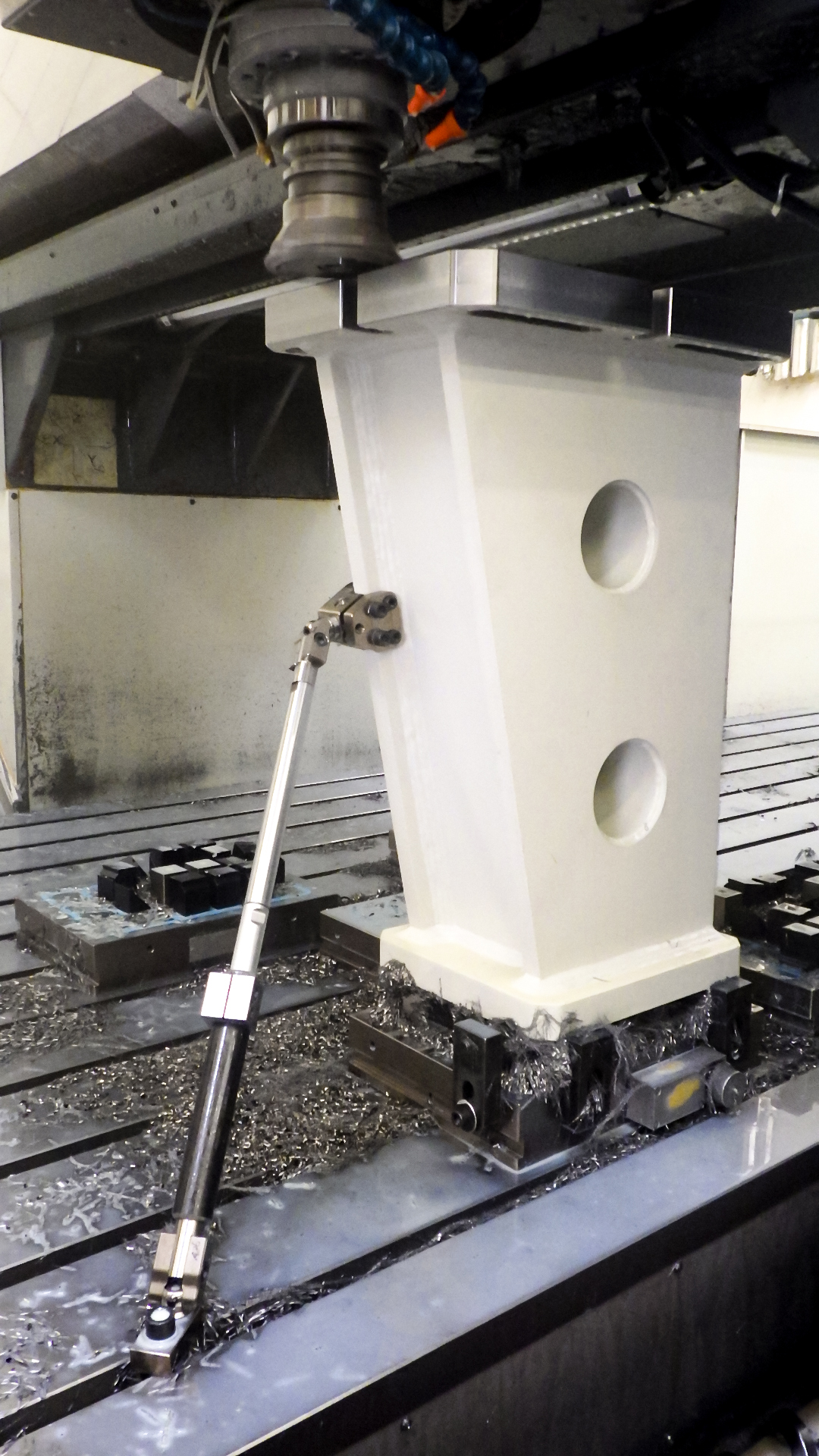

A second application called for machining tall parts. A Unilock Stabilizer System was incorporated that attached to a worktable to provide lateral part support and offset cutting forces being exerted against the part. This reduced changeover times, mitigated vibration that could cause errors, , and took stress off the spindle.
