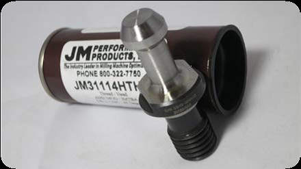

A few years ago, Boeing contacted one of its tooling manufacturers, Briney Tooling Systems, Bad Axe, Michigan, a leading supplier of CNC toolholders and shrink-fit tooling systems in North America, reporting that they had performed testing that revealed a flaw in the V-flange tooling the company was using. Requesting a solution, Briney reached out to JM Performance Products, Inc., Fairport Harbor, Ohio, to elicit their assistance in resolving the problem Boeing described. In turn, within the following week, JMPP began an intrinsic investigation and ultimately designed a gage that mirrors the interior grind of a CNC spindle. This gage measures movement or growth of the toolholder taper down to 7.5 millionths inch in diameter.
JMPP identified that the essential flaw, the invisible problem plaguing CNC manufacturers, as toolholder expansion. Using their gage to perform extensive testing, JMPP proved that toolholder expansion is caused by the installation of a standard retention knob into a V-Flange holder.
Briney had reported expansion of their holders with as little as 13 ft.-lbs. of torque during retention knob installation. This expansion creates a bulge in the holder at the small end, causing the holder to make contact with the small end instead of the large end. This effectively reverses the way the toolholder is designed to fit the spindle, allowing the holder to move randomly within the spindle. This movement results in a loss of contact between the spindle and the toolholder, and causes a laundry list of issues: vibration and chatter, excessive runout, poor finishes, shortened tool life, high power consumption, excessive spindle wear, need to slow down, and the need to reduce the depth of cuts.

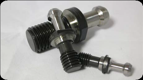

Using the taper shank test fixture, JMPP redesigned the knobs, finally reaching a design that eliminated or substantially eliminated toolholder expansion. The company's patented High Torque retention knobs are designed
to thread deeper into the bore of the holder where there is a thicker cross-section of material to resist deformation.
