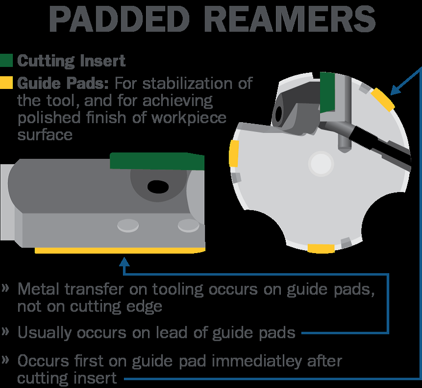

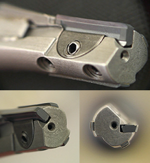

As the name implies, the padded reamer differs from a fluted reamer in that the padded reamer has a cutting surface and guide pads that ride on the diameter of the hole to put pressure on the cutting surface, which generates the hole size and geometry. The guide pads also act as a burnishing tool to help provide a smooth surface finish. Because the pad forces are "riding" on the inside surface of the hole, significant lubrication is necessary in padded reamer operations to eliminate scratches on the hole surface and maintain the required surface finish. Lubrication
is especially critical for the first guide pad after the cutting surface. Therefore, metalworking fluids play a critical role in the optimization of padded reamer applications for the following reasons:
♦ Metal adhesion to the reamer pads is one of the primary routes to failure and loss of surface finish:
-- Inadequate lubrication of the padded reamer may result in scratches in the bore from aluminum pick-up on the guide pads leading to surface finish issues. The primary purpose of the metalworking fluid is to supply a sufficiently thick film to maintain low friction between the workpiece and the guide pad surfaces. This film prevents metal adhesion and subsequent surface finish degradation
