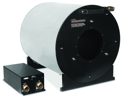

The 120K-W Laser Power Meter measures high power beams at a distance past the focal spot of the laser or, alternatively, at a distance from the diverging fiber output where the beam has expanded to about 100mm diameter.
A reflective cone in the meter deflects the laser beam onto the inner circumference of the sensor. This increases the radiated area and reduces the power density to manageable levels. As the cone dissipates the beam, it captures over 99 percent of the radiation, minimizing safety hazards. The response time of the 120K-W is less than 1 minute, a fraction of the time required by custom, non-commercial systems.
Unlike other high power measurement systems, the 120K-W Laser Power Meter is a compact, portable unit. It consists of a beam dump with overall dimensions of about 50cm diameter x 50cm deep, and a water flow power measurement unit of 11x15x34cm. The meter connects to a PC via RS-232 and is provided with software that displays and graphs the power and water flow rate. A smart connector output displays power readings on any of Ophir's smart displays.
