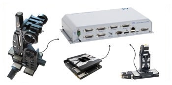

PI (Physik Instrumente) has released a new 6-axis servo motor controller – the C-884.6DC. Most modern precision motion systems are driven by servo motors, because they provide high torque, fast acceleration, smooth motion with a wide dynamic speed range and fast start/stop performance.
October 12, 2017
PI's compact C-884 DC motion controller can run brushless servo motors and traditional DC motors with closed loop feedback provided by incremental encoders and absolute encoders (BiSS protocol). USB, TCP/IP and RS-232 interfaces are standard for command communication. Additional interfaces such as programmable analog and digital I/O lines, an SPI display port and joystick port are also included.
The dual-core architecture provides for increased performance and flexibility by separating command processing and position servo control functions.
