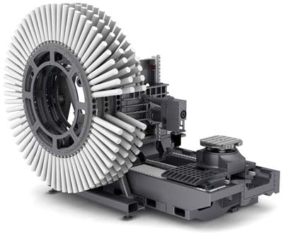

The field of application of the DMC 60 H linear is varied: Gearbox and coupling housings, cylinder heads or for example hydraulic blocks. However, all workpieces make high demands on accuracy and require a high degree of flexibility. With the most recent model of the DMC H series, DMG/Mori Seiki create the perfect basis for a broad range of applications, starting with the optimum utilisation of the work area: With the standard version the maximum workpiece size is 800 x 1,030mm with a weight of up to 600 kg. The travelling column concept enables traverse paths of 630, 800 and 850mm in X-, Y- and Z-direction. DMG/Mori Seiki have also considered the requirements of the users with regard to the design of the DMC 60 H linear and developed a machine with optimum ergonomics and a space requirement of just 11.9 m² for the pallet changer version.
The linear drives of the X-, Y- and Z-axes are at the centre of the machine concept. This makes rapid traverse speeds of up to 100 m/min and acceleration values of 1 g possible. A warranty period of 60 months underlines the longevity of this wear- and maintenance-free drive technology.
DMG/Mori Seiki use an oil/air lubricated model as main spindle for the standard version with 12,000 min-1. It has a capacity of 20 kW and a torque o 110 Nm. Optionally an 18,000 rpm spindle with 34 kW and 110 Nm is available. For heavy machining, DMG/MORI SEIKI provide a spindle with a powerful torque with 10,000 min-1, 46 kW and 200 Nm.
To minimize thermal deviations, DMG/Mori Seiki rely on comprehensive cooling of all relevant components, like linear drives, motor spindle and NC round table. Furthermore, all drives are outside of the work area, to avoid temperature affecting the machining. The compact rotary magazine is one of the special highlights. The basic version of the DMC 60 H linear has a magazine with 63 tools, which can be extended by four more rings with 60 additional pockets each. Apart from the slim design of 2,500mm, the extremely fast provisioning times even for a large number of tools of 3.4 up to max. 5.6 seconds and extremely short chip-to-chip times of 2.2 seconds are impressive. This innovative concept ensures that the maximum version of the machine with 303 tools just gains 1 metre in width.
A particular feature is the option to insert new tools into the magazine (from two wheels) with the tool changeover active – parallel primary time and auxiliary time tooling. Cone cleaning and broken tool detector parallel to primary processing time round off the excellent overall picture. With regard to the development of the DMC 60 H linear, DMG/Mori Seiki also have optimised chip removal within the machine. Steep and vertical covers ensure an unhindered fall through the machine bed. A spiral conveyor in the center of the machine transports the chips to the rear, so that connection to a central chip removal can be easily realised. The modular design of the DMC 60 H linear enables different configuration levels. The highest range of machining options is achieved with the 5-axis version. Here the traverse paths are 630/800/750mm, whereby the maximum workpiece size is 800 x 800mm and the workpiece weight is up to 450 kg. The swivel range of the NC round table is 220 degrees and ranges from -20 to +200 degrees. The 5-axis as well as 4-axis version of the DMC 60 H linear are optionally available for the powertrain version as version with pallet changer.
