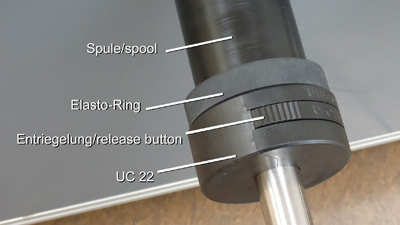

When a U-Clip is placed on a shaft to hold a reel or core in place, the reel or other object begin secured, can create back pressure against the U-Clip. For example, the flanges on a reel may bulge as the spool fills. As the flanges expand and push against the U-Clip collar, the increasing pressure may interfere with the function of the quick release mechanism and make it difficult to remove the U-Clip.
The Elasto-Ring washer snaps onto the end of the U-Clip collar. When the U-Clip is in place, the Elasto-Ring is against the spool flange, between the flange and the U-Clip. If back pressure starts to build, it is largely absorbed by the Elasto-Ring which flexes against the U-Clip collar. This effectively cushions the U-Clip and prevents a significant build up of back pressure. The quick release feature assures fast, easy, one-handed removal of the U-Clip and Elasto-Ring.
Elasto-Ring washers are available in the same ten sizes as U-Clip collars for use on shafts with diameters ranging from 8mm to 35mm. Made from durable, heat resistant rubber, Elasto-Ring washers are long lasting and will not deteriorate from heat generated by friction coming from the rotating spool flange.
