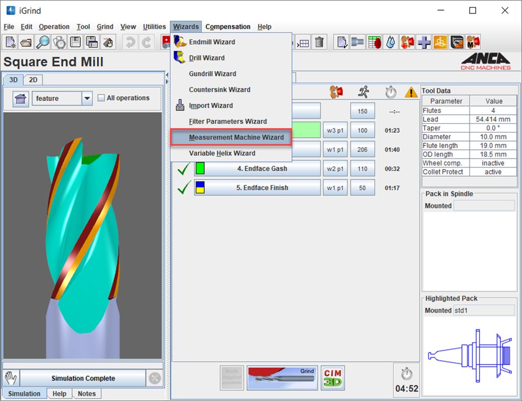

The ToolRoom Measurement Wizard remains the easiest way to set up ANCA-ZOLLER measurement feedback. This guides the user through the available list of features for a given tool. The user can easily select which features can be measured and have compensation applied.
The user can also specify the required length/angle tolerance for each parameter so that values within tolerance will not be compensated when returned from ZOLLER.
Each feature is initially set with a default (recommended) location for measurement (red line), although this can be manually adjusted before sending the data to ZOLLER for measurements and tolerance settings can be imported from another Tom file to avoid resetting all parameters and tolerances individually again.
When measurement data (GDX® file) is imported to the ANCA grinder, the measured parameters are brought as nominal value but compared against design value and adjustments made accordingly. Values within tolerance will not be compensated but users have an option to override this function.
