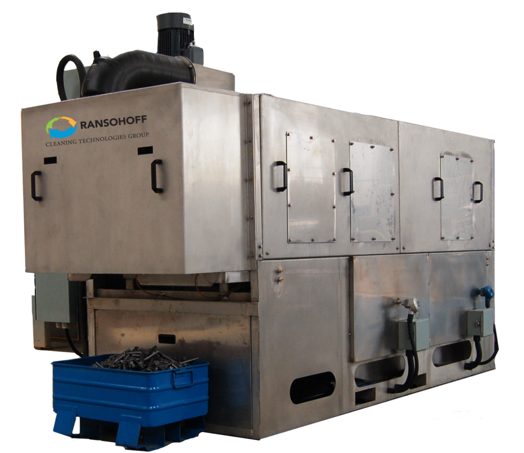

Ransohoff has introduced its LeanDrum CF Washer. This new platform provides an energy-efficient, reliable solution for high-volume cleaning needs, along with a design for cold forming applications.
June 15, 2017
The LeanDrum CF features stainless steel tanks, a drum and housing, premium electrical components, full immersion cleaning system and forced-air dryer technology to produce consistently high-quality cleaning results over an extended machine life, according to the compay. With this new design, users may recognize less chemical utilization and have better oil control resulting in a longer bath life. In this new design, users can apply more aggressive chemicals without foaming. The LeanDrum CF is designed for easy access that will allow easy drum removal for maintenance, with no crane required.
The LeanDrum CF is a wash, rinse and blow-off machine in a small footprint of 5.3 ft. wide x 11 ft. deep x 5.3 ft. high. The part production rate is 12 cu. ft./hour at 2-rpm design drum speed, with a variable-speed drive capable of 1 to 3 rpm. This machine offers full immersion cleaning, eliminating any need for pumps and nozzles.
