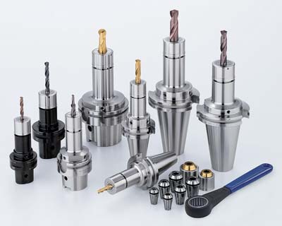

BIG Kaiser Precision Tooling Inc. has introduced Mega ER Grip, a new premium ER collet chuck system featuring a runout accuracy of .00012" (3µm) at 5xD.
November 1, 2010
BIG Kaiser Precision Tooling Inc. has introduced Mega ER Grip, a new premium ER collet chuck system featuring a runout accuracy of .00012" (3µm) at 5xD. The Mega ER Grip was designed to outperform all other ER systems in the four most crucial areas of tool holder performance: clamping force, concentricity, rigidity and balance at high spindle speeds. These factors, combined with the system's reliable and stable runout accuracy, amount to significant long-term savings. A major design improvement increases the contact length of the internal taper of the chuck body, reducing the undesired overhang of the collet for significant performance enhancements.
"Our tests have shown that Mega ER Grip performs exceedingly well in these four areas," says Jack Burley, BIG Kaiser vice president of sales and engineering. "The result is cost and down-time reduction thanks to longer tool life. Customers will also see improvements in machining quality and shorter production times because of reduced cutting vibrations."
All components of the Mega ER Grip system are manufactured with BIG Daishowa's production technology: a high-rigidity body, a precision notch-free nut and an AA-grade ERC collet. ERC collets are in accordance with DIN6499 and ISO15488 standards and feature a clamping range of .075" to .787" in diameter.
With the Mega ER Perfect Seal, coolant can be delivered through the tool or to the cutter periphery. Tapped holes around the body periphery promote precision balancing, and the system is only available with dual-contact BIG-PLUS (CAT), HSK and CAPTO interfaces to ensure maximum rigidity.
