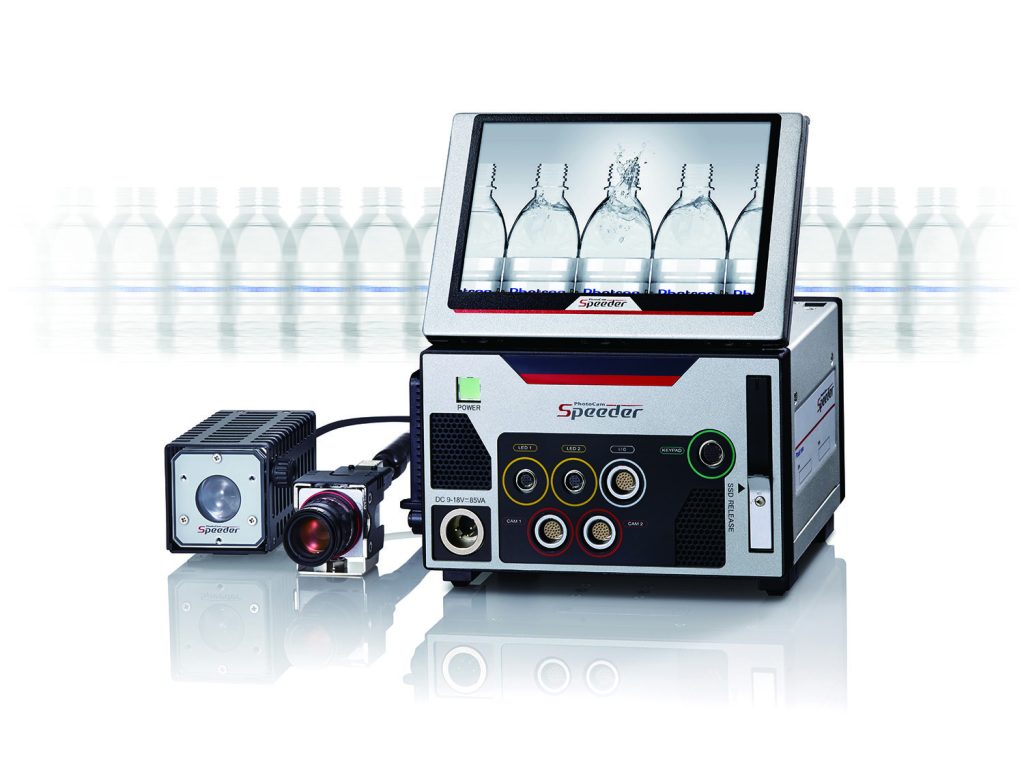

Photron Inc. introduces the PhotoCam SpeederV2. The portable, standalone high-speed camera system is specially designed for production fault-finding. Intuitive and easy to use, the camera system allows workers to quickly view and identify production errors on the integrated 7-inch LCD remote touch screen, without the need for a computer or network infrastructure.
The SpeederV2 system is available with one or two miniature, remote camera heads that are tethered to a compact camera control unit. The new production line imaging system provides up to 2,000 frames per second (fps) at full pixel resolution (512 x 512) and higher frame rates at reduced resolutions. There are two video recording modes: speed priority mode for high-frame-rate, full-resolution video capture to the onboard internal memory; and time priority mode for extended duration video capture (i.e. very long recording times at reduced frame rates and/or resolutions) which can be streamed to an integrated solid-state drive (SSD).
The PhotoCam SpeederV2 system operator can easily start or stop a recording manually using the touch screen or a simple thumb switch. Alternatively, the system can be automatically triggered with a TTL pulse or switch closure emitted in the event of equipment failure or production line disruption. Importantly, once the video is recorded, it can be played back in super slow motion, allowing factory personnel to view the production error and make necessary corrections immediately.
