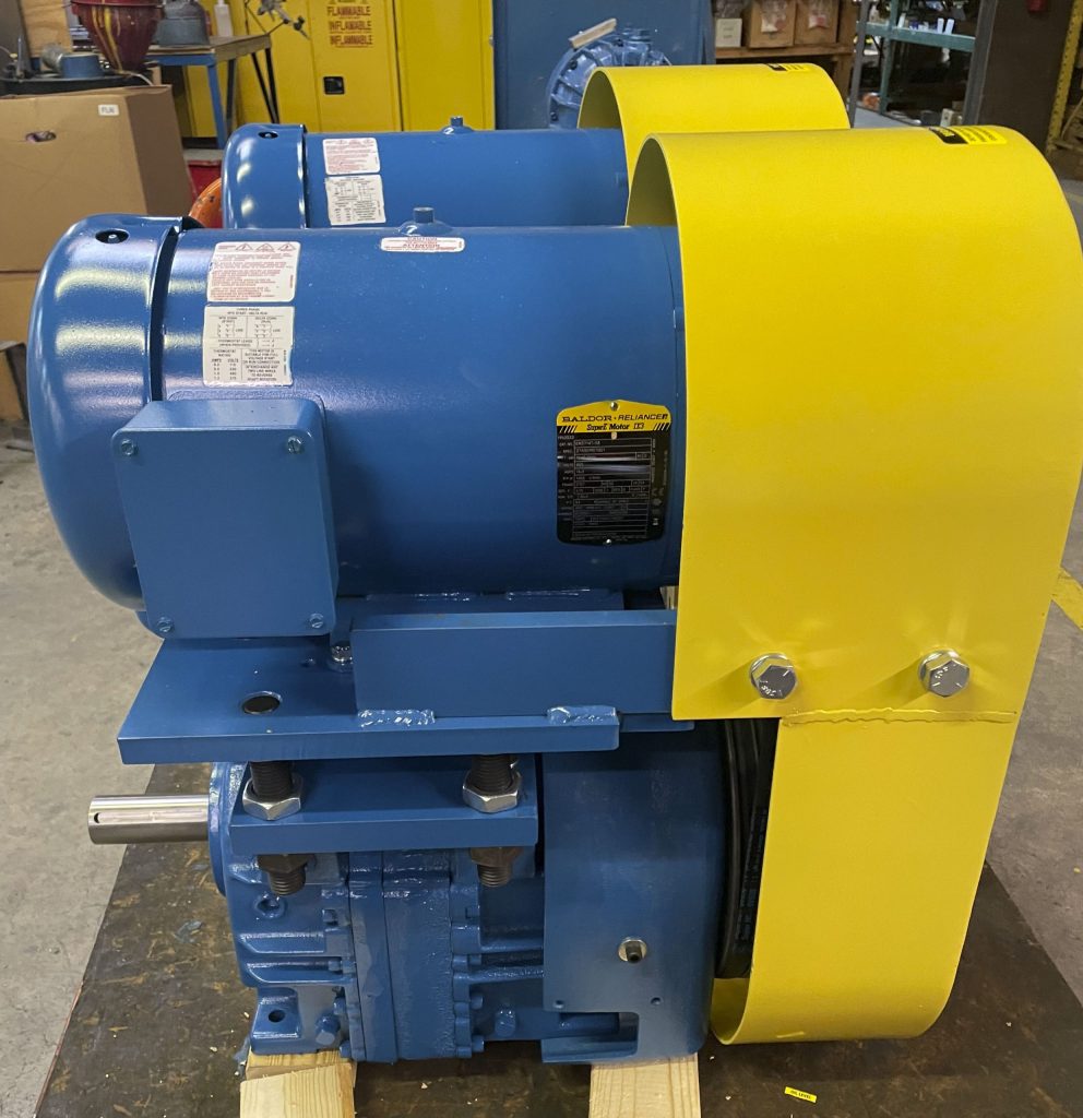

Posidyne® clutch brakes can be ordered with special pads cast into the main housings to mount an adjustable motor base, allowing the motor to sit atop the clutch brake in a space saving “piggyback” design. Ideal for precise positioning applications with tight space constraints where an inline arrangement is not feasible, this arrangement also includes a gear belt drive from the motor to the input shaft and an enclosed belt drive guard.
Designed for tight quarters, the Posidyne® features oil shear technology that allows rapid and precise stopping, starting, speed change and positioning, all without adjustment or maintenance. Posidyne® piggyback clutch brakes are well suited for applications with frequent start/stop cycles, and high cycle rates (up to 300 cycles per minute), which place a high priority on maximizing production and minimizing downtime.
