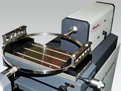

Now Mahr provides the capability to measure such parts in their undeformed state as a standard feature on their Precimar PLM 600-2 high precision length measuring systems. This capability is especially important for measuring thin-walled work pieces, such as the rolling bearing ring pictured. If a technician checks the inner or outer diameter of a bearing on a length measuring machine during quality control, the bearing can be deformed even at low applied forces, thus distorting the measurement results.

The Mahr deformation correction function is fully automated and available as part of the standard application tools set in the Precimar PLM 600-2 system's controller. The procedure automatically modifies the measuring force in a specified sequence, while reliably recording the corresponding change in the part's measured size. This allows the system to determine the actual elastic properties of the part, which are used, in turn, to calculate the given length in the unloaded, measured force-free state of the part.
The measuring machine initially generates a measuring force of 1.2 N, then, invisible to the user, automatically reduces the measuring force in steps of 0.02 N from 1.2 N to 0.8 N, and determines the corresponding measured values. The principal advantage of this procedure over other static measurements is that the calculated length value is based on a number of individually measured values and therefore yields an uncertainty level lower than any respective single measured value. The Precimar PLM 600-2 is designed to test a wide range of equipment and suitable work pieces quickly and easily, and with the smallest possible uncertainty.
