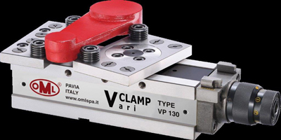

OML's VariClamp modular clamping system from Lexair Inc. uses a floating mechanism of fixed and moveable jaws and a variety of gripper forms to provide custom clamping of irregular-shaped workpieces, including round, curved, elliptical, rectangular, stepped and slanted parts. VariClamp vises can be configured with any combination of fixed or swiveling jaws, and various styles and heights of grippers, including smooth, serrated, soft, high, and with or without stops.
Grippers are added via holes placed throughout the vise to conform to the part shape, and holes are capped and covered when not in use. A swivel mechanism incorporated into the moveable jaw allows for easy clamping of slanted and rough-surfaced parts. The super-low profiles of the fixed and moveable jaws also allow clamping of thin workpieces for heavy duty cutting and precision processing.
VariClamp vises are available with an optional mechanical clamping force multiplier/limiter that sets the grip force from one to four tons. Operators can easily set and maintain the grip force to prevent part distortion and establish accurate, repeatable clamp force with a simple, one-handed turn.
Available in three sizes (100mm, 130mm and 160mm), VariClamp's wide opening and compact length make it particularly suitable for use with machining centers. An expanding chip cover prevents chips from falling into the lead-screw and inside the vise.
These vises are made of GGG-60 ductile iron with a tensile strength of 80,000 psi (60 kg/mm2). The vise bed is flame hardened to 5 HRC for long-term accuracy, jaws are hardened and ground to 52~55 HRC.
