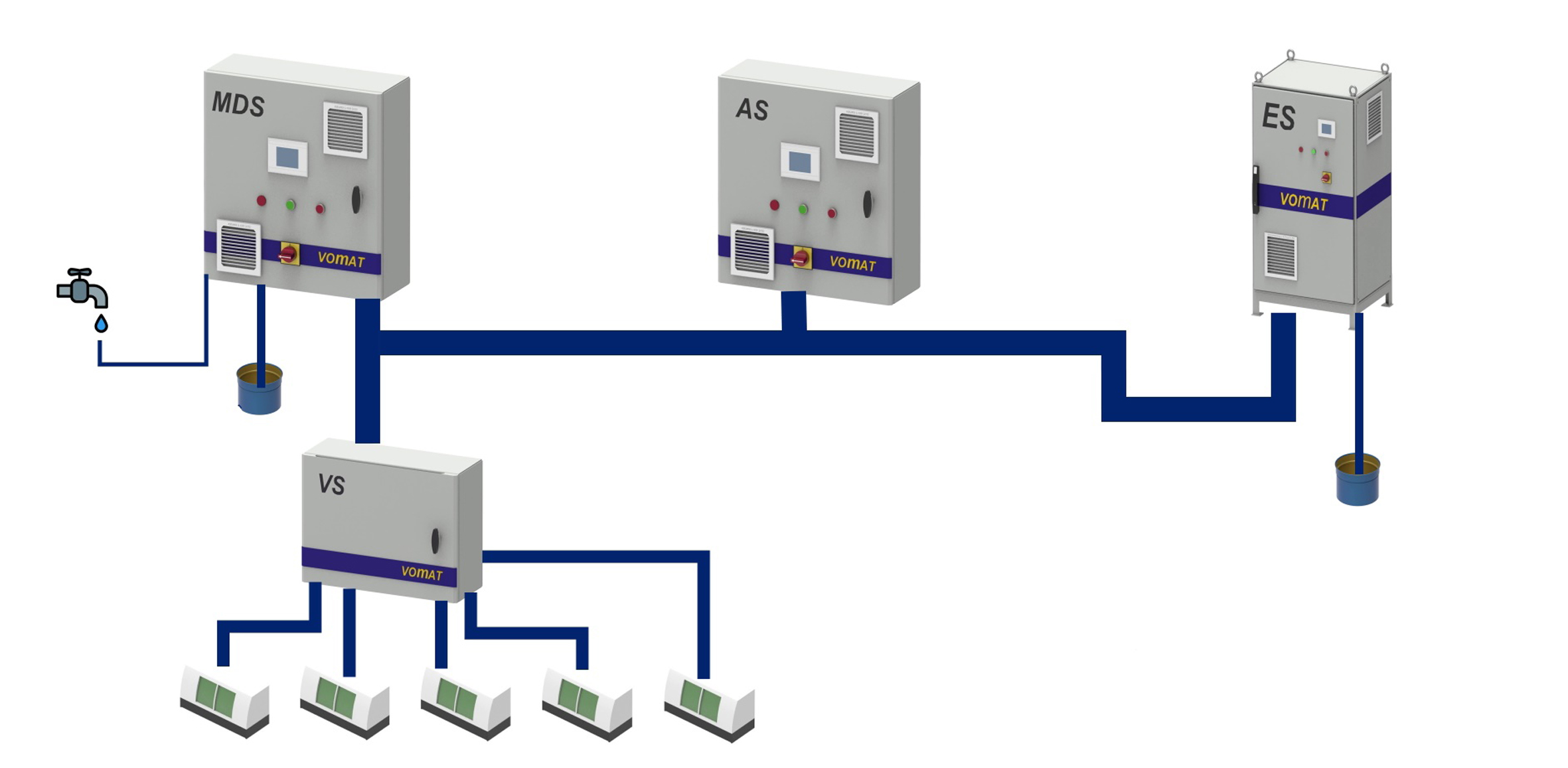

With a fully automatic maintenance system, Vomat now makes the use of water-miscible MWF even more time- and cost-optimized. The system has a modular design and can be integrated into the respective conditions of each grinding system as required.
The heart of the system is the fully automatic mixing and dosing system (MDS) with a tank size of up to 10,000 liters, which constantly regulates the defined ratio of water quantity and coolant concentrate with high precision. Steffen Strobel: "During grinding, there are drag-out losses, and some of the cooling lubricant also evaporates, so that the quantity and mixing ratio of water and concentrate are constantly changing. This can negatively affect the usage properties and shorten the service life. It is therefore important that the machine operator continuously checks the mixing ratio and can take corrective action if necessary. Our MDS now takes over this manual process, including the prescribed logging. This saves time, costs and significantly increases process reliability."
In addition, the grinder can use an analysis module (AS) that identifies process-destabilizing contaminants, such as particles from the grinding process, and determines their content. A special extrusion system (ES) removes these contaminants.
Steffen Strobel: "Our new maintenance system is modular, energy-efficient and compact. It helps to significantly increase the service life of water-miscible cooling lubricants in grinding processes. And a special distribution unit even allows the connection of several grinding machines."
