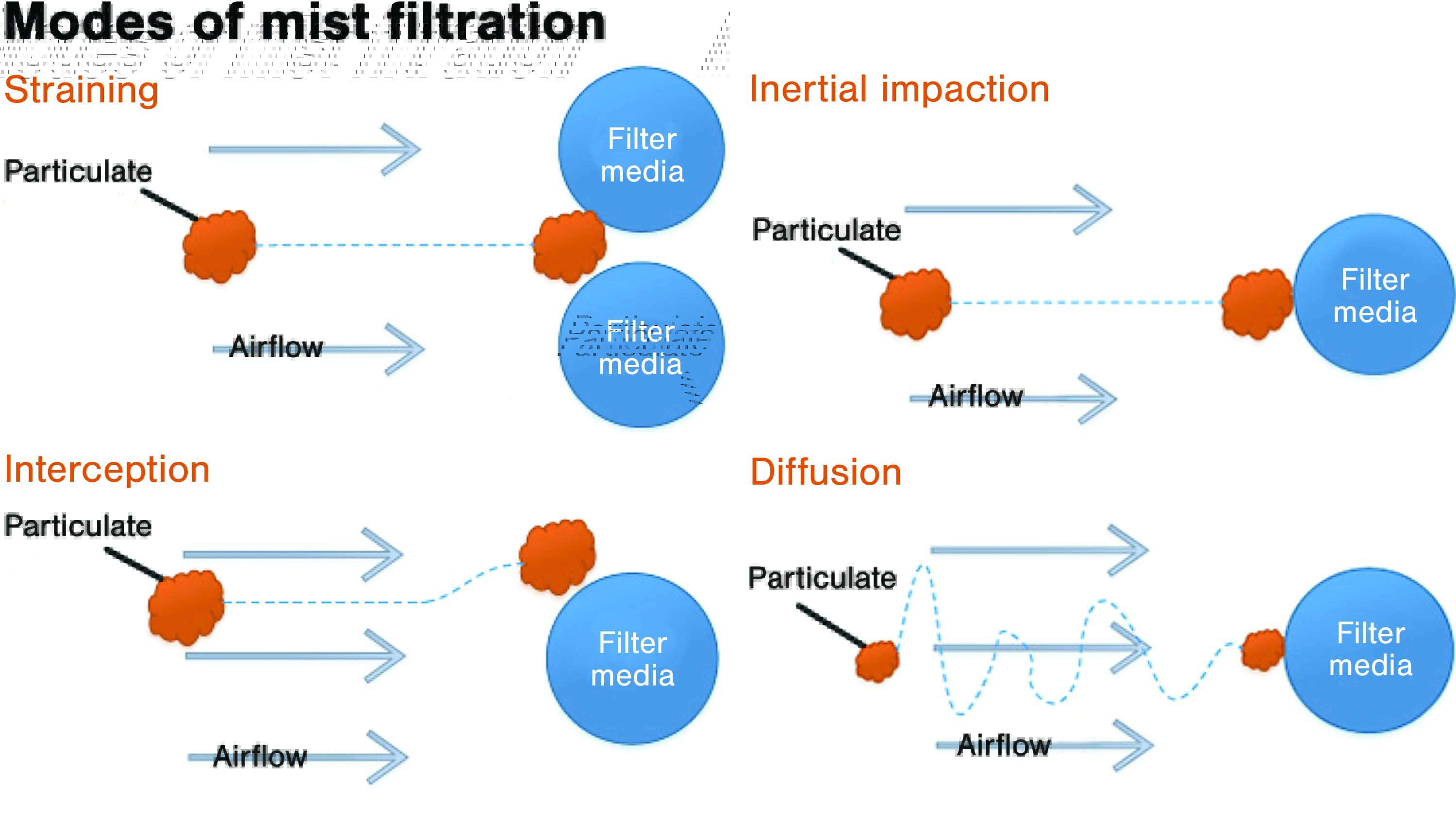

Filter mediums should be chosen based on the particle size of the mist. Make sure a filter effectively can remove submicron particles from the airstream. To be effective, a filter medium will use high pressure and require high energy costs to force air through.
Devices that use coalescing mediums as a mode of filtration need less energy and can last up to 10 years. The other filtration method uses noncoalescing mediums, which are fibrous mediums that must be thrown away once saturated. While these filters do not demand much energy, they are not very efficient and must be replaced continually.
Oil mist requires specialized equipment for collecting wet particulate matter, along with a different type of filter. Filters created for dry particulates, such as dry grinding dust, quickly become clogged and ineffective if used for oil mist. Wet mist collectors pull mist-laden air into the bottom of a collector, where larger droplets can fall out before air is pulled into a filter medium.
Packed-bed, or coalescing, filters are most effective for most oil mists. These filters capture tiny droplets on fibrous mediums, and the droplets then coalesce into larger droplets. When enough liquid accumulates, it simply drains off the filter medium into a collector. These filters continue to work even when fully saturated, and they continually clean themselves as liquid drains off. The collected metalworking fluid then can be further filtered for reuse.

The best way to determine if a system works effectively is to test the air that travels in and out of a collector. Packed-bed filters with multiple layers of tightly woven fibers work well for both mechanically and thermally generated oil mists.
Packed-bed filters can handle some dry-soluble particulates, which simply wash away with liquid as it coalesces. However, if a process generates large amounts of nonsoluble particles that mix with oil mist in the air, you may need to consider a pre-filtering process.
There are different approaches to separate solid particulates and liquid oil mists. Disposable pre-filters can be used to strain out large solids before oil mist reaches a packed-bed filter. This is a fairly inexpensive approach but can be maintenance-intensive, mainly because filters need to be changed frequently. Impingement plates or chevron-style pre-filters capture solids and keep them from entering a fiber bed filter. These are periodically washed to remove accumulated solids.
