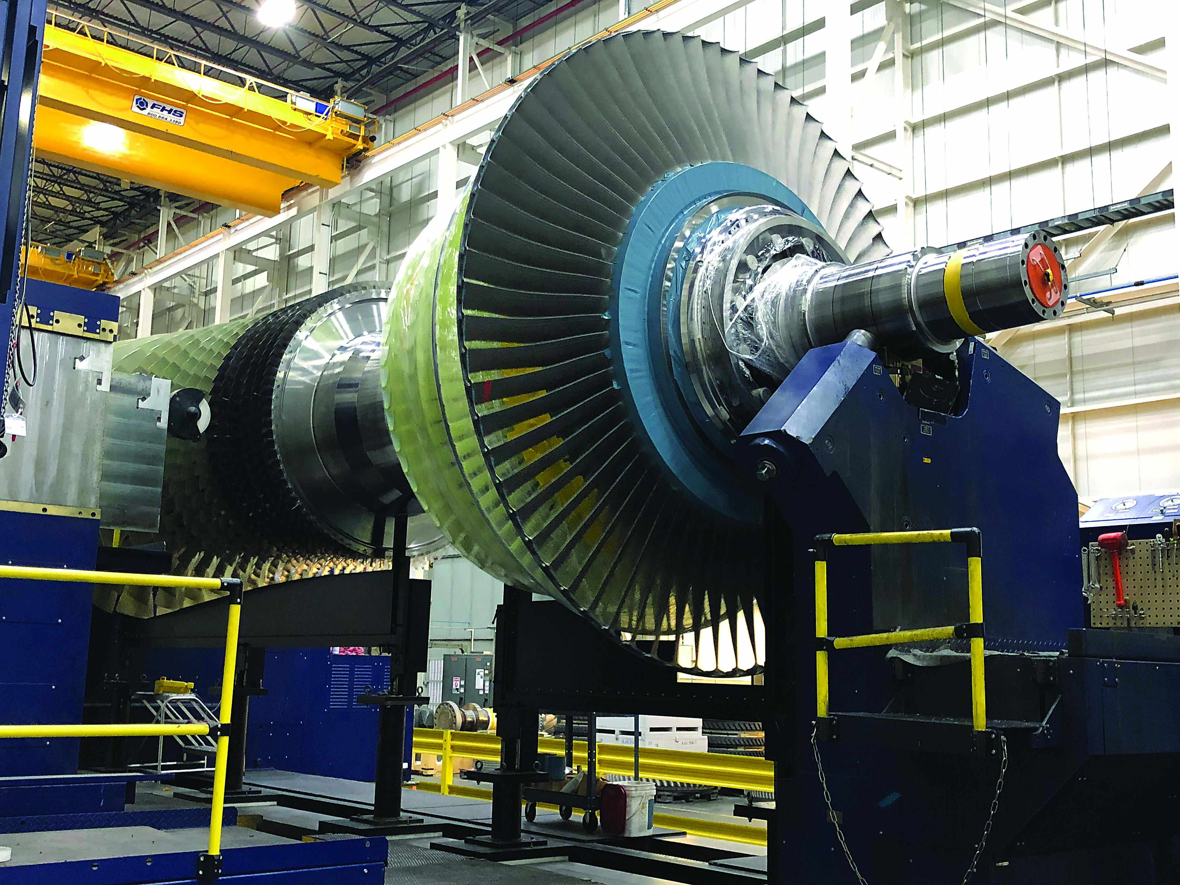

Gas turbine rotors can weigh 64 metric tons (70 tons) when fully assembled. The largest lathe at Mitsubishi Hitachi Power Systems Americas is rated at 200 metric tons (220 tons). Image courtesy of C. Tate

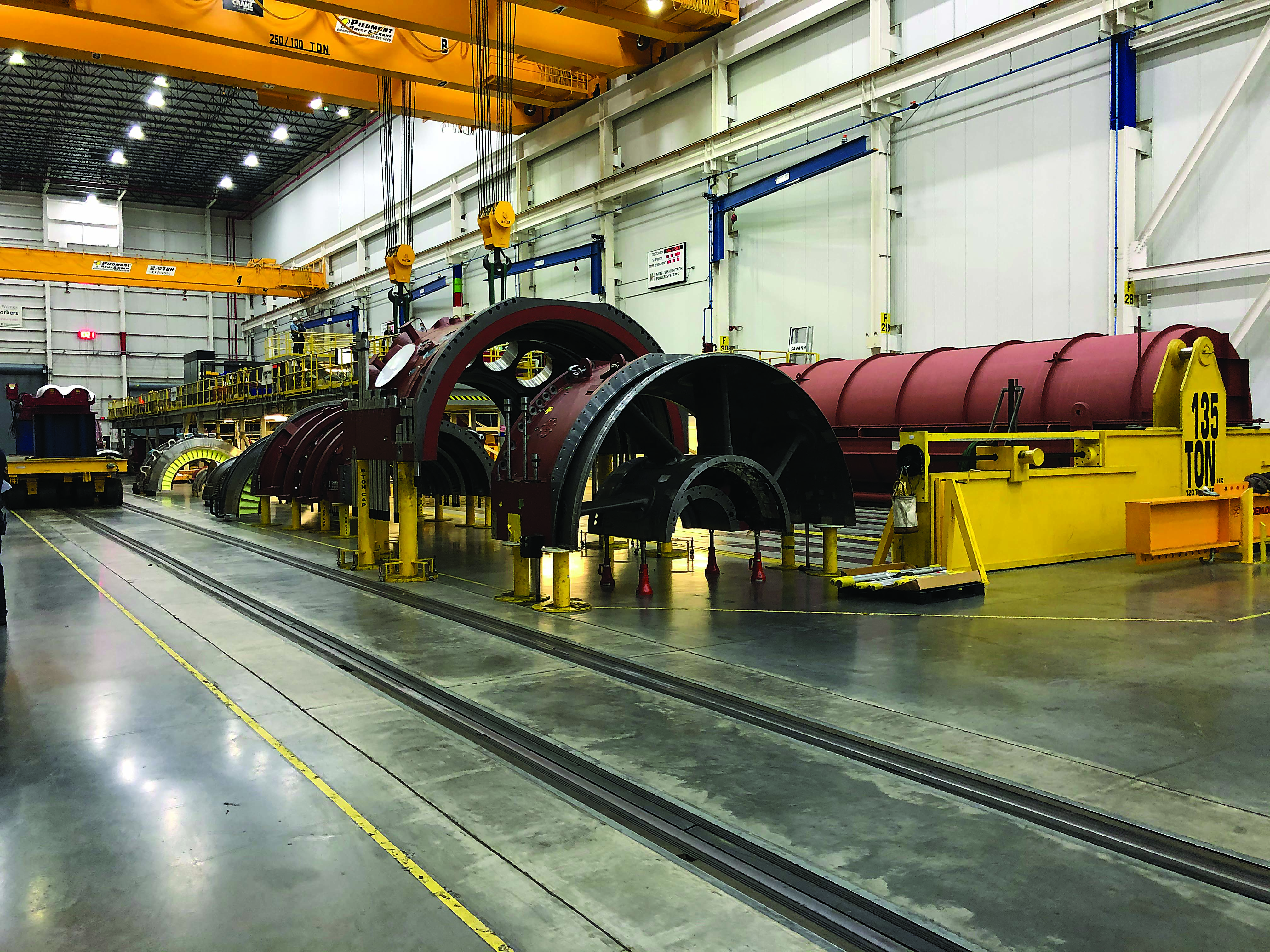

Casings for gas turbines are enormous. The overhead cranes are rated at 226,796 kg (500,000 lbs.) each. Image courtesy of C. Tate
Small parts are subjected to distortion from clamping, stress relieving and aggressive machining. Big parts are worse. They are subjected to the same issues but have an added challenge: weight. Large parts can distort under their own weight, causing problems like bowed shafts or out-of-round rings. Some machining processes start with a “slow roll” in which we allow a sizable shaft to rotate for an entire shift to remove a bow before we machine. In some cases, like with a ring that has a thin section relative to the diameter, we must perform stress-relieving heat-treat operations before taking a part to a machine. This prevents movement during machining operations that require big ovens. Our largest oven is 10 m (33′) deep and 4 m (13′) tall — almost spacious enough for a semitrailer.
Estimating cycle times is similar to estimating for small parts. To calculate cutting times, we use our CAM software the same way that a user would for small parts, but that is where similarities end. Small parts are loaded by hand, and handling times are only a few seconds. Our handling times for big parts are measured in hours. It can take two hours to flip a large cylinder and three to four hours to move a gas turbine rotor from one end of the shop to the other. It is necessary to account for all material handling or else cycle time and lead time estimates can be wrong by multiple shifts.
