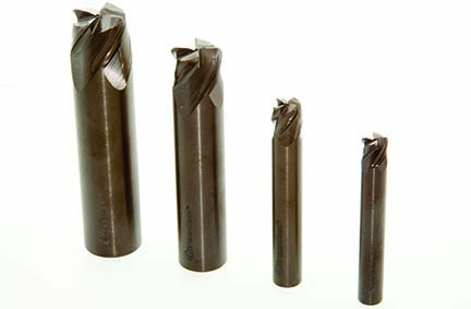

Xsytin-360 solid-ceramic endmills feature internally grown reinforcing for greater strength.

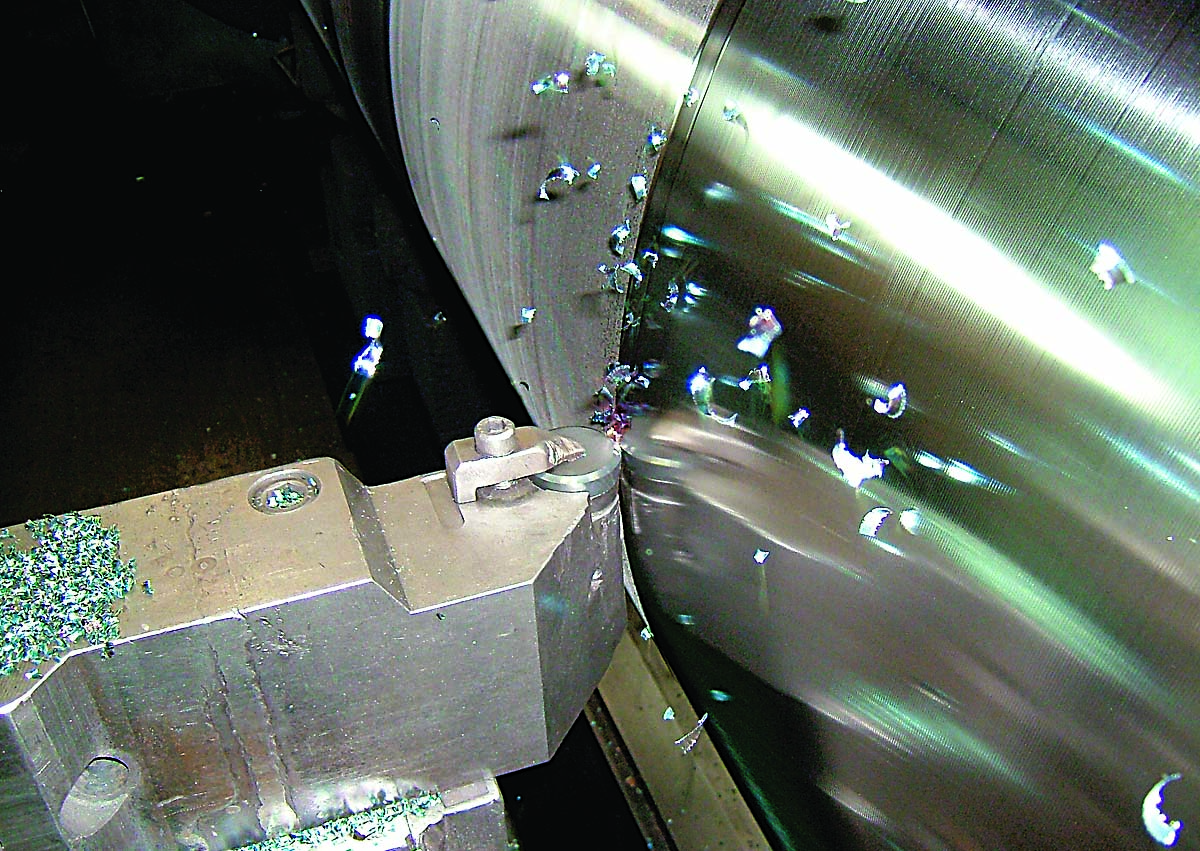

Better Than Grinding
At Greenleaf, Dillaman and his colleagues have had success using ceramic inserts to replace grinding in some cases.
“Some customers were using OD grinding or surface grinding for hardened materials just because that’s the traditional method that has been used,” Dillaman said. “But with ceramic inserts, you can remove large amounts of material much quicker than you could in a grinding application.”

NTK Cutting Tools' black ceramic removes material on a steel mill roll application.
“You may still have to do some finish work with an electrode, but the amount of electrodes consumed should be much reduced,” he said.

A relatively new entry in the ceramic tool market from Greenleaf is its Xsytin-360 line of solid-ceramic endmills. Launched last year, Xsytin-360 endmills come in standard diameters down to 3/8″, so they can cut much smaller features than indexable tooling.
Dillaman said these endmills are made from the company’s Xsytin-1 material, which features a “whisker,” or reinforcing material, that’s grown internally via processing rather than laid in. This makes the ceramic material much harder to break apart, he said. He added that Xsytin-1 has shown itself to be capable of handling challenging roughing applications and turning interruptions.
