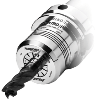

While discussing cutting tools during a meeting, Potts recalled that Michael Morgan, a regional sales representative for HORN USA Inc., Franklin, Tenn., presented a CENTRO/P precision collet chuck distributed by HORN and manufactured by FAHRION Vertriebs-GmbH, Kaiserbach, Germany. Potts was immediately impressed. “The holders are visibly amazing,” Potts said, “and you just feel the difference in them.”
However, he found the beauty of these collet chucks isn’t only skin deep. According to FAHRION, the CENTRO/P collets have a maximum accuracy of 2µm and achieve a system accuracy of 3µm at 3 times diameter, 50mm maximum, when matched to its chucks. This is six times the precision of a conventional ER collet chuck, the company added.

The FAHRION CENTRO/P precision collet chuck from HORN USA achieves a system accuracy of 3µm.
“It’s not just what that collet chuck looks like, but also how it performs,” Potts said. “It doesn’t vary whether you have a short collet chuck or a standard-length one; you get the same accuracy.”
That minimal runout enables an endmill, for example, to machine at a feed rate of up to 400 ipm when clamped in a CENTRO/P collet chuck, whereas the tool would chatter when held with a conventional collet chuck, according to Potts. Minimal runout also enables all cutting edges to equally engage the workpiece material and extend tool life while taking a larger DOC compared to a conventional clamping system, he added. Potts noted he didn’t replace any tools held with the precision clamping system even after machining 150 parts during a 3-day demonstration at a trade show. “The main thing is my cutting tools are lasting a lot longer.”
According to the manufacturer, the chuck offers maximum symmetry with minimum residual imbalance and has a ground 30° trapezoidal thread and special coating on the nut to ensure accurate centering of the nut on the chuck. In addition, the precision collet chucks provide a G2.5 balance at up to 30,000 rpm. Because the CENTRO/P collet sits completely inside the collet closing taper, it does not apply the usual bridging, thereby enabling holding forces twice as high as those of conventional collet chucks, according to the manufacturer.
