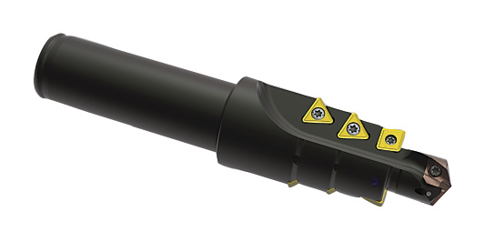

GEN3SYS 3-step.tif
Courtesy of AMEC
Allied Machine & Engineering Corp. engineers custom Gen3sys combination tools like this for use in special applications in aircraft landing gear, engine components and hinges.
While the modified tool may be able to machine the prototype parts, it may not work the best, and may result in an unstable condition with a longer cycle time. In many of those cases, Hughes said, Greenleaf can analyze the application and engineer a special with the rigidity necessary for increased metal-removal rates and reliability, often utilizing Greenleaf's WG300 or WG600 ceramic inserts or one of the company's high-performance coated carbide grades. "We can focus on the problem features, or we can be called in at the very earliest stages of process planning," he said. "In general, we like to be called in early so we can develop a tool layout."
