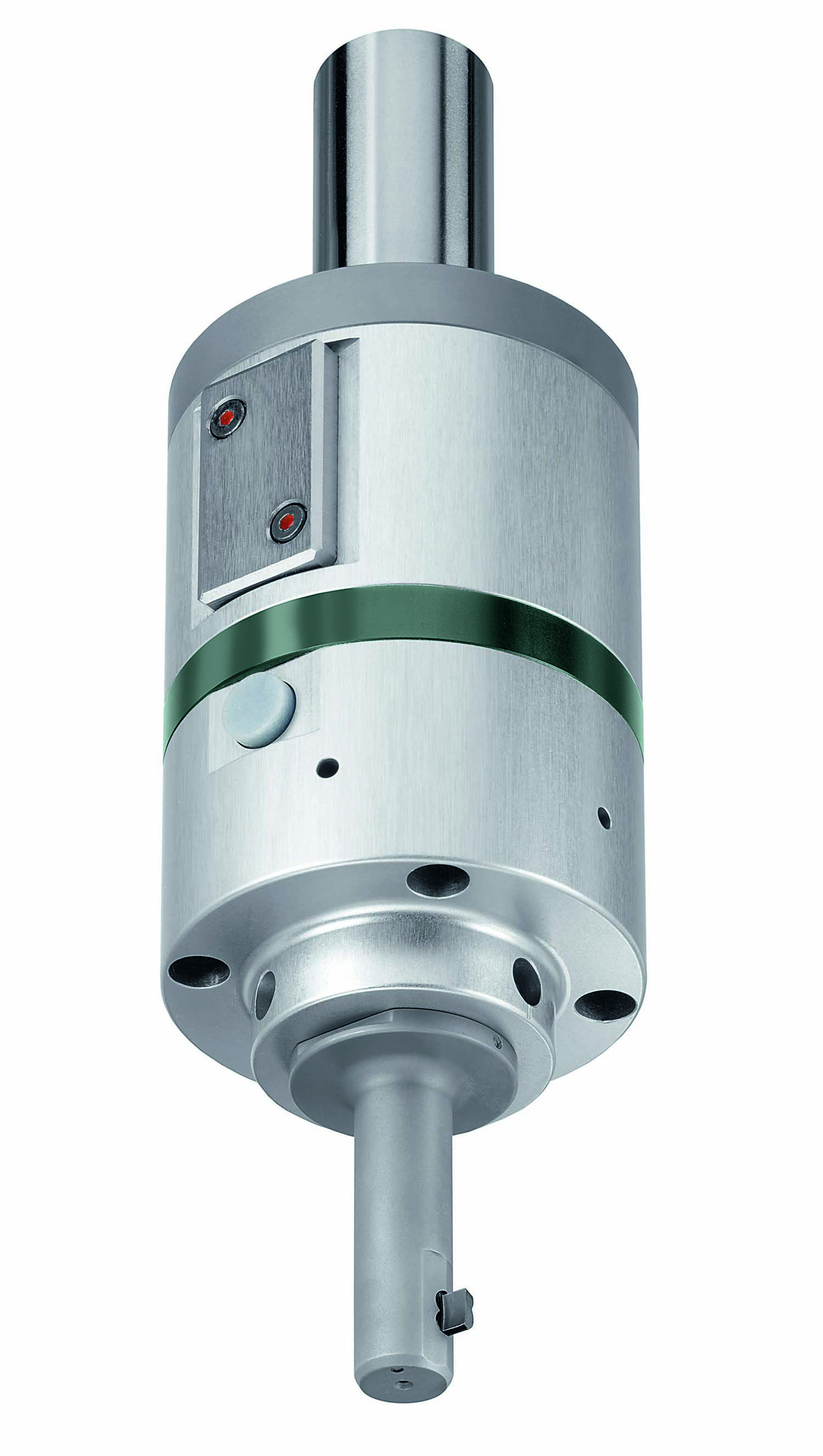

It’s niche work to be sure. But due to the large volume of aircraft being made, never mind the number of countersunk holes in each one, there’s no shortage of high-quality custom and off-the-shelf cutting tools. One example of the latter comes from Heule Tool Corp., Loveland, Ohio. President Gary Brown said the company’s Comp combination countersinking and holemaking tools automatically compensate for the uneven surfaces found on many aircraft parts.
“The surfaces on these parts can vary by a quarter inch (6.35 mm) or more in height, so you need a tool that can float up and down while remaining perfectly perpendicular,” he said. “Our Comp tools are used on the doors for the 737, for instance, each of which has around 800 fasteners. But we also see a lot of demand from turbine manufacturers who need to chamfer both sides of a hole. For this, our Defa tools are a popular option, or the Solo, which has a retractable, spring-loaded blade. One of our largest customers uses these in an automated machine to put 100° countersinks on engine fairings.”
