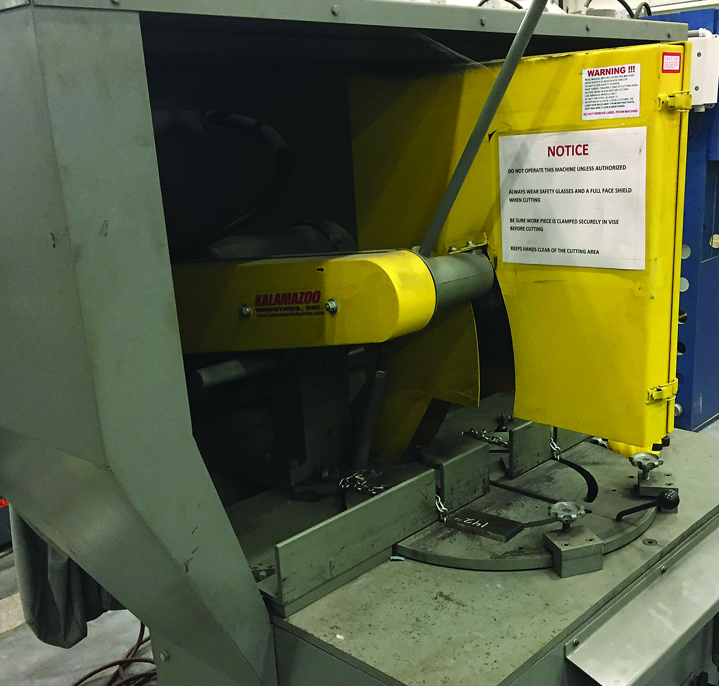

A saw can cut many sizes of bar and is limited only by the size of stock that will fit physically into a machine. Saws also are capable of cutting an infinite number of shapes as long as a piece may be clamped. In addition, saws can be tooled up to cut odd shapes, whereas ironworkers and shears are dedicated to specific shapes. Saws do not cause edge deformation, and a good saw delivers very clean cuts and square ends. Shearing machines are definitely faster, but a saw is more flexible and provides a better cut.
Bandsaws, cold saws (aka circular saws) and abrasive saws are common types of saws, and each has many different combinations of blade materials, styles and sizes to choose from. Of course, there are numerous kinds of blades for cutting metals, plastics and wood, but blades also are made specifically for cutting materials like fiberglass, rubber and ceramics. There are saws and blades for every application. All these variations give an endless combination of possibilities, making sawing a universal operation.

Abrasive saws are fast and easy to use. They are as accurate as other types of saws but dirty. Image courtesy of C. Tate
