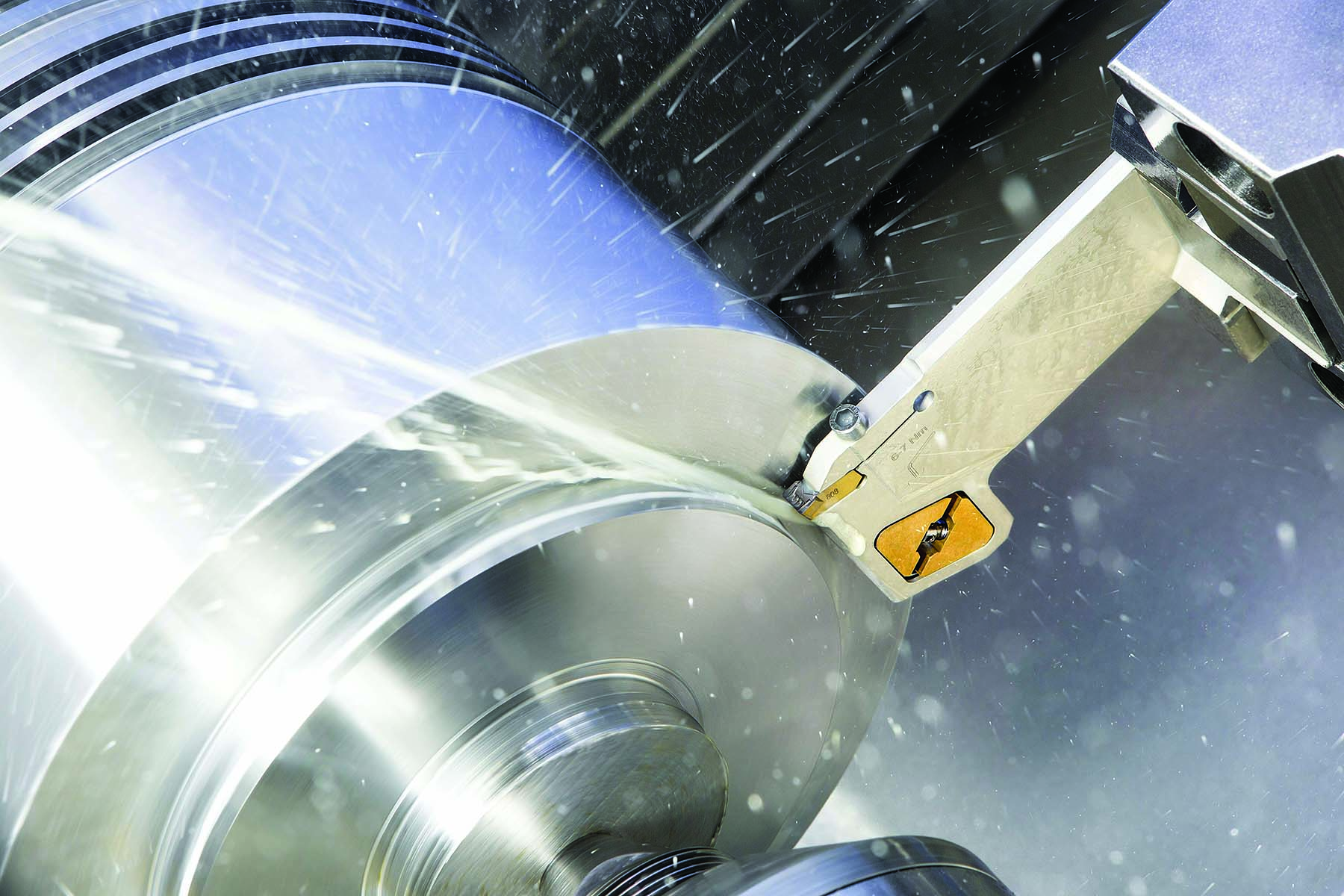

Coolant sprayed from channels within the tooling helps keep a tool from overheating. Image courtesy of Iscar USA

High-quality tooling used to cut HRSAs might have built-in holes and channels to support flowing coolant during machining. Keeping heat away from the tool and out of the part is a big focus in creating a good groove. With the introduction of coolant that was supplied directly through the cutting tool, heat became better controlled, letting tools last longer.

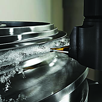

An industrial groover works on a large plate of titanium. Image courtesy of Sandvik Coromant

Another part of the puzzle comes from customers. Whenever a shop works with specialty materials, the design of the part needs to be considered carefully. It's also imperative that the customer understands the budgetary differences. Running titanium alloys requires a machine to cut slower, feed material slower and take more frequent breaks. These differences result in more time and attention on the machine, leading to higher quoted prices and longer turnaround times.
