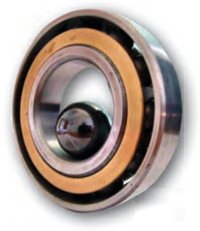

Editor’s Note: An immeasurable number of roller bearings, pumps, hydraulic and other devices are in use and their service life depends on the working capacity of “ball-type” parts. Service life of standard ball-type parts is too low, especially when they are exposed to abrasive, corrosive and other severe, wear-causing environments. Similar parts made of ceramic materials have high hardness and chemical wear resistance, which significantly increases service life.
A review of international studies about ceramic materials concludes that these materials can be used to make high-strength, ball-type parts. Such parts would effectively work in valve, bearing and other mechanisms for various industries, including chemical, machine building, defense and oil and gas.

Applying a special diamond wheel (Figure 1) and lapping tools are recommended to achieve high-productivity precision grinding, which produces ceramic balls with an average surface roughness less than or equal to 0.05µm Ra (2 µin. Ra) and out-of-roundness of about 0.5µm to 1.0µm (about 20 to 40 µin.). The novelty of these tools is the presence of multiple-profile surfaces.

This grinding technology is required to achieve accurate geometric parameters of the ceramic balls, which will increase grinding productivity two to three times compared to the standard process to manufacture steel ball bearings.
Analysis of practical results of this study reveals this grinding technology effectively produces ceramic balls used in roller bearings. Such hybrid bearings were developed in Ukraine for the first time. It was shown that a mechanism with ceramic ball bearings consumes 10 to 14 percent less power compared to one with standard steel balls.
Also, productivity of pumps used in the oil and gas industry increased 20 to 25 percent because their valves had ceramic balls. Such valves have a higher wear resistance in severe media compared to valves with standard steel balls. CTE
