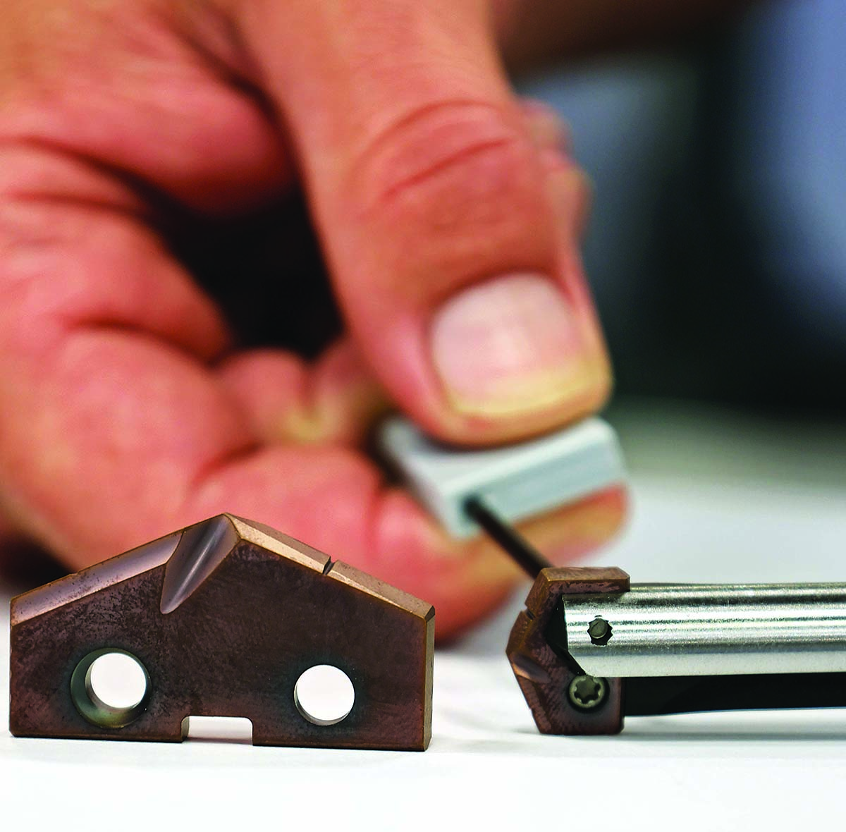

“Today,” he said, “inserts are increasingly favored because, thanks to improved coatings and geometries, they perform extremely well in hard or abrasive materials.”

Successful holemaking depends highly on matching the drill to the correct toolholder. For routine operations, a collet holder is sufficient, but deep-hole drilling demands both increased strength and vibration dampening.
“We’ve seen a good deal of progress in conventional holders,” Hobbs said. “For instance, our ISO 9766 holder reduces the runout that you would find in a traditional Weldon holder. When it comes to deep-hole drilling, the choice would fall between shrink fit and a hydraulic chuck. The hydraulic chuck is the better choice over the long term because it is more economical and safer since it does not require high temperatures to connect the tools to the holders.”
Pilger recommends a hydraulic chuck with a sleeve for solid-carbide drills over eight times diameter.
“The hydraulic reduces runout to within 2.5 microns,” he said, “and the hydraulic fluid also acts as a vibration dampener. We’ve also found that tool life improves up to 25%.”
