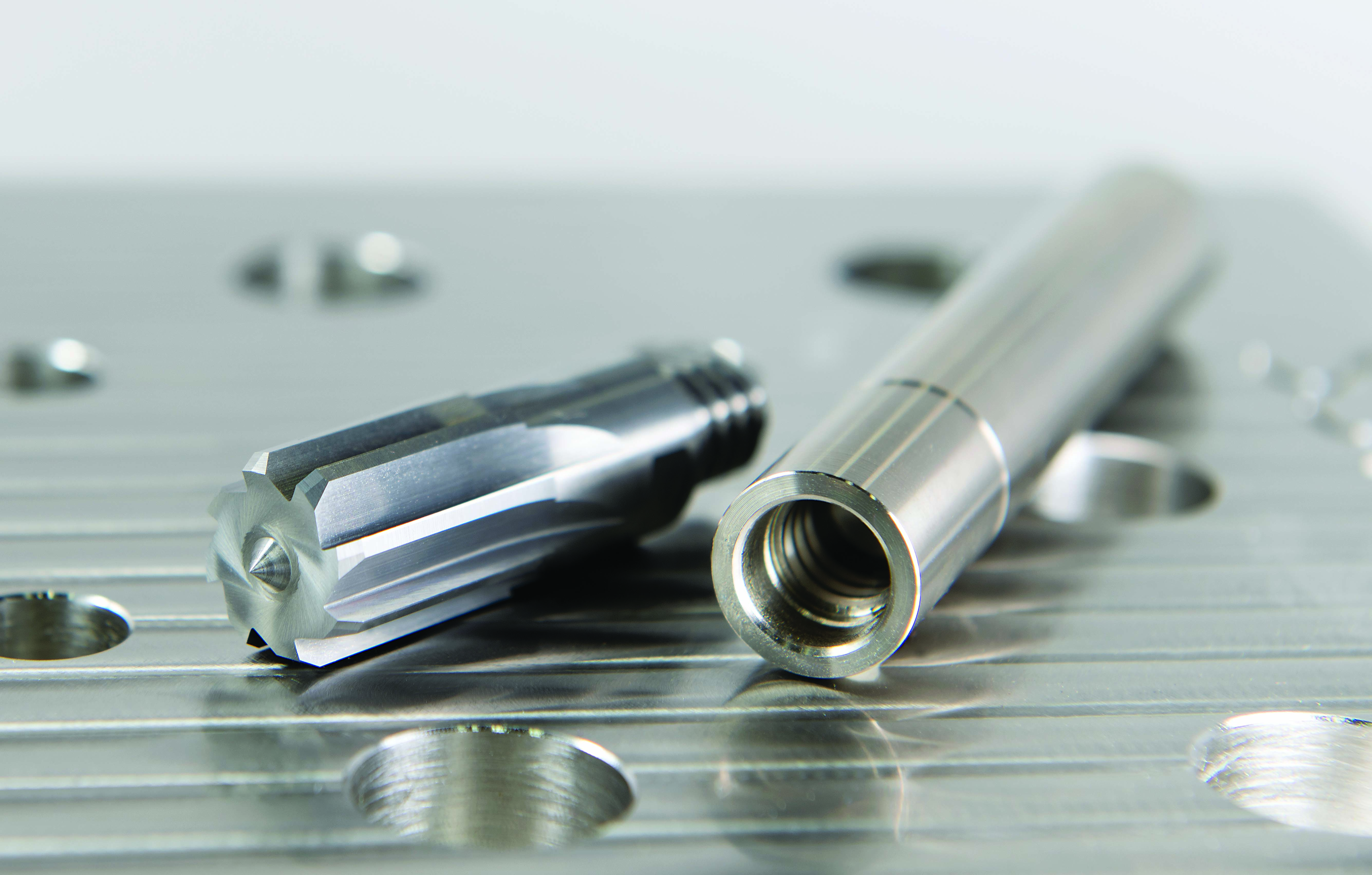

The Bayo T-Ream reamer  from Iscar is equipped with a bayonet screw and special wrench for rapid changeovers. Image courtesy of Iscar Metals
What defines large? Depending on the style of head, the PXM system covers diameters from 10 mm to 32 mm (0.39" to 1.26"), a range that Gennuso said complements OSG USA’s solid-carbide reamer line.
“The vast majority of machined holes are 9⁄16" (14.29 mm) in diameter or smaller,” he said, “and for most of these, solid reamers are the best choice. For larger diameters, however, the PXM lineup provides the advantages of a solid cutting tool with the flexibility and cost benefit of an indexable platform.”
These reamers are also quite accurate. In OSG USA’s case, the PXM offers 0.015 mm (0.0006") or less of radial runout and axial repeatability within ±0.03 mm (0.0012"). This is accomplished via a buttress-style, screw-on carbide head whose face and taper mate with a cylindrical steel shank, similar to an HSK spindle or a comparable dual-contact mount.

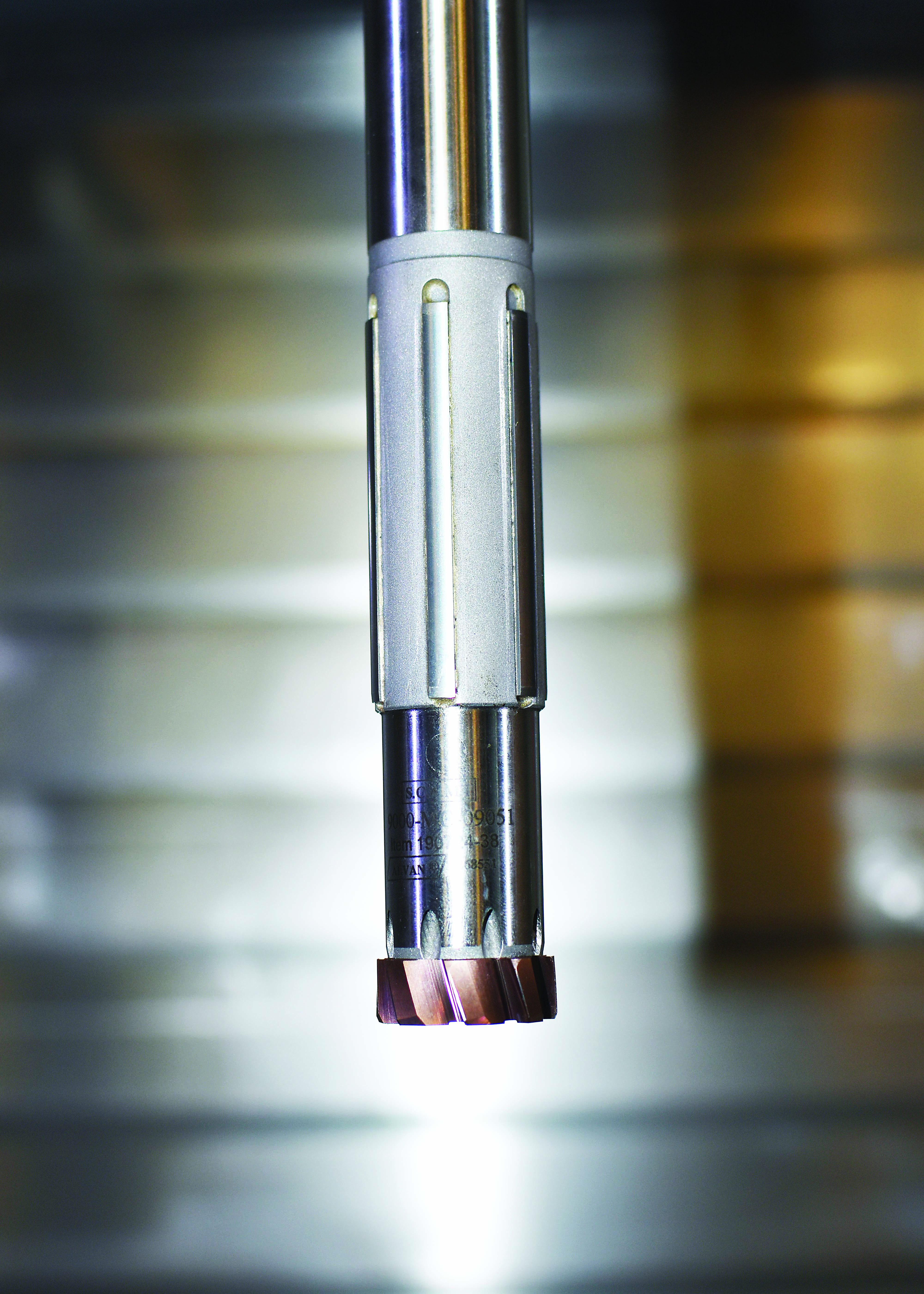

Since the early 2000s, Allied Machine & Engineering has partnered with S.C.A.M.I., a manufacturer of modular reamers.  Image courtesy of Allied Machine & Engineering
The reamer line’s monoblock style covers hole diameters from 5.8 mm to 32.1 mm  (0.228" to 1.264") while the replaceable-head series is slightly larger at 11.8 mm to 60.6 mm (0.465" to 2.386"). Both kinds are available in fixed or expandable models. There’s also a ring-style reamer that ranges from 17.6 mm to 200.6 mm (0.693" to 7.898").
“It’s a very versatile product line,” Morrett said. “We have different grades of cermet, carbide, PCD and CBN available, as well as various coatings and geometries, so there’s little we can’t handle materialwise. With that in mind, I would say that most of our customers are using them for production work, such as hydraulic manifolds and firearm components.”
He said his statement about production work is not meant to scare off job shops and other high-mix, low-volume manufacturers that benefit from the product’s broad application range and ability to expand holes up to 1% of a reamer’s diameter. The sticking point is cost: Whereas a five-person shop might balk at spending an additional 30% or more for a modular reamer, high-volume manufacturers easily can justify it based on cost per hole.
“I worked with a shop recently that was getting around 1,000 parts out of a brazed carbide reamer,” Morrett said. “By switching to our Alvan solution, they increased that to 14,000 parts. So, yes, our tool costs roughly one-third more than a conventional reamer, but the delta is insignificant when you consider the productivity improvements.”

Hole quality is also a critical factor when selecting a reamer, he said. Iscar’s Bayo T-Ream interchangeable-head reamer, which covers diameters from 11.5 mm to 32 mm (0.453" to 1.26"), guarantees diametral head accuracy of ±2.03 µm (0.00008") and 3 µm (0.0001") runout and indexing
repeatability.
“In most applications, we can easily hold hole size within 5 µm (0.0002") even while feeding 50% faster than a traditional carbide reamer,” Vetrecin said. “This makes our system a favorite in the aerospace, automotive and indeed any industry where hole quality is just as important as throughput.”

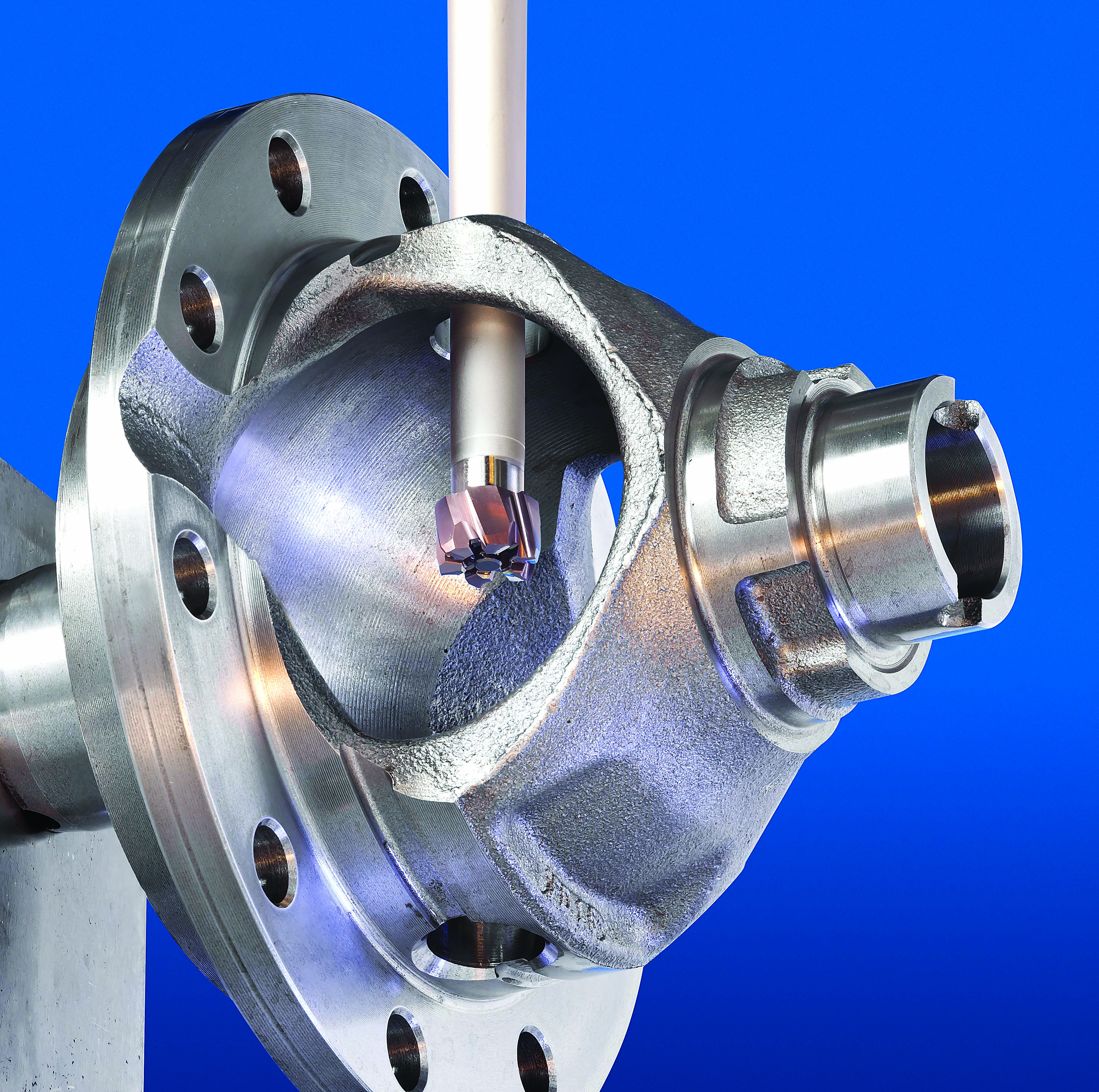

Because only the head of the tool is made of carbide, modular reamers are cost-effective for many reaming applications. Image courtesy of OSG USA
Throughput also depends on setup time, and modular reamers don’t disappoint. The Bayo T-Ream, for example, is equipped with a bayonet screw and special wrench for rapid changeovers. Perhaps more important than speed is simplicity, however. Considering the shortage of qualified workers, modular reamers offer a set-it-once approach, after which anyone can replace heads with a screwdriver.
