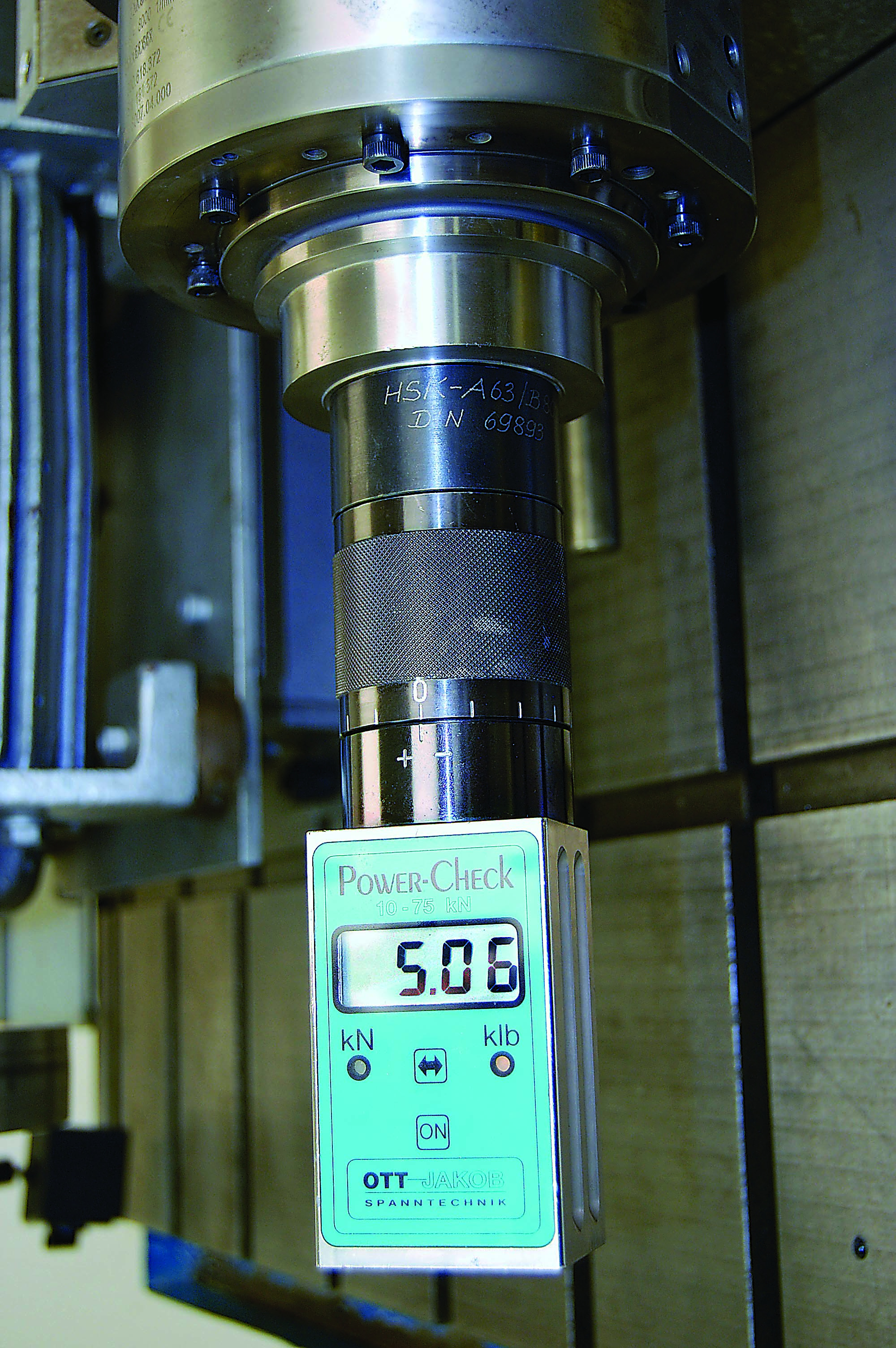

  • Use the force. When the Belleville washers found in most machining center drawbars fatigue, their grip on toolholders within the spindle taper becomes less secure. Microscopic holder movement ensues, hurting part quality and tool life and most likely damaging the spindle and toolholders as well. The solution is a drawbar force meter, which allows operators to quickly inspect this often overlooked machine component. Although a meter can cost $1,000 or more, the investment may mean avoiding damage to a spindle that could easily cost 10 times that amount to repair.

Checking the drawbar pull force is an important part of any machining center maintenance routine. Photo credit: High Speed Technologies
Routinely checking the drawbar pull force is an important part of any machining center maintenance routine. Image courtesy of High Speed Technologies

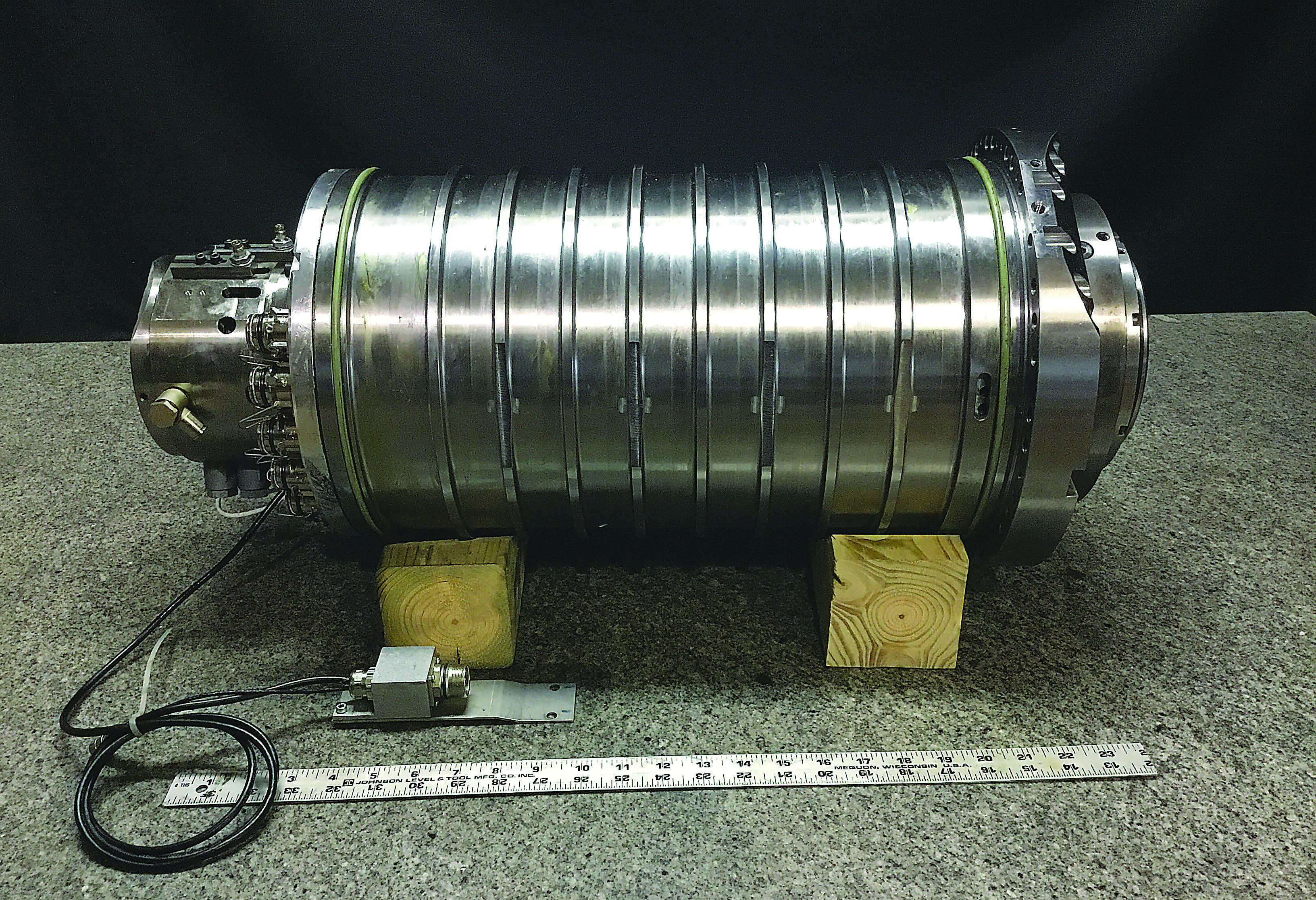

Assuming that your shop follows this article’s recommendations, there’s a good chance of being able to replace spindle bearings yourself—Valenze even offers a multipart tutorial on his blog at www.highspeedtechnologies.com/blog. But for shops that would rather focus on making parts or in situations where a spindle is damaged to the point that grinding is necessary, send it to a company that specializes in spindle repair.
A newly rebuilt spindle, ready for installation at a customer’s facility. Image courtesy of Motor City Spindle Repair.
Motor City Spindle Repair Inc., Dearborn, Michigan, is one such company. Owner and Vice President Brian Burns agrees that many shops can perform basic spindle rebuilds, especially shops with less demanding work. However, he noted, bringing the spindle back to factory specifications—remanufacturing it, in other words—is the most cost-effective, dependable solution for most machine shops.

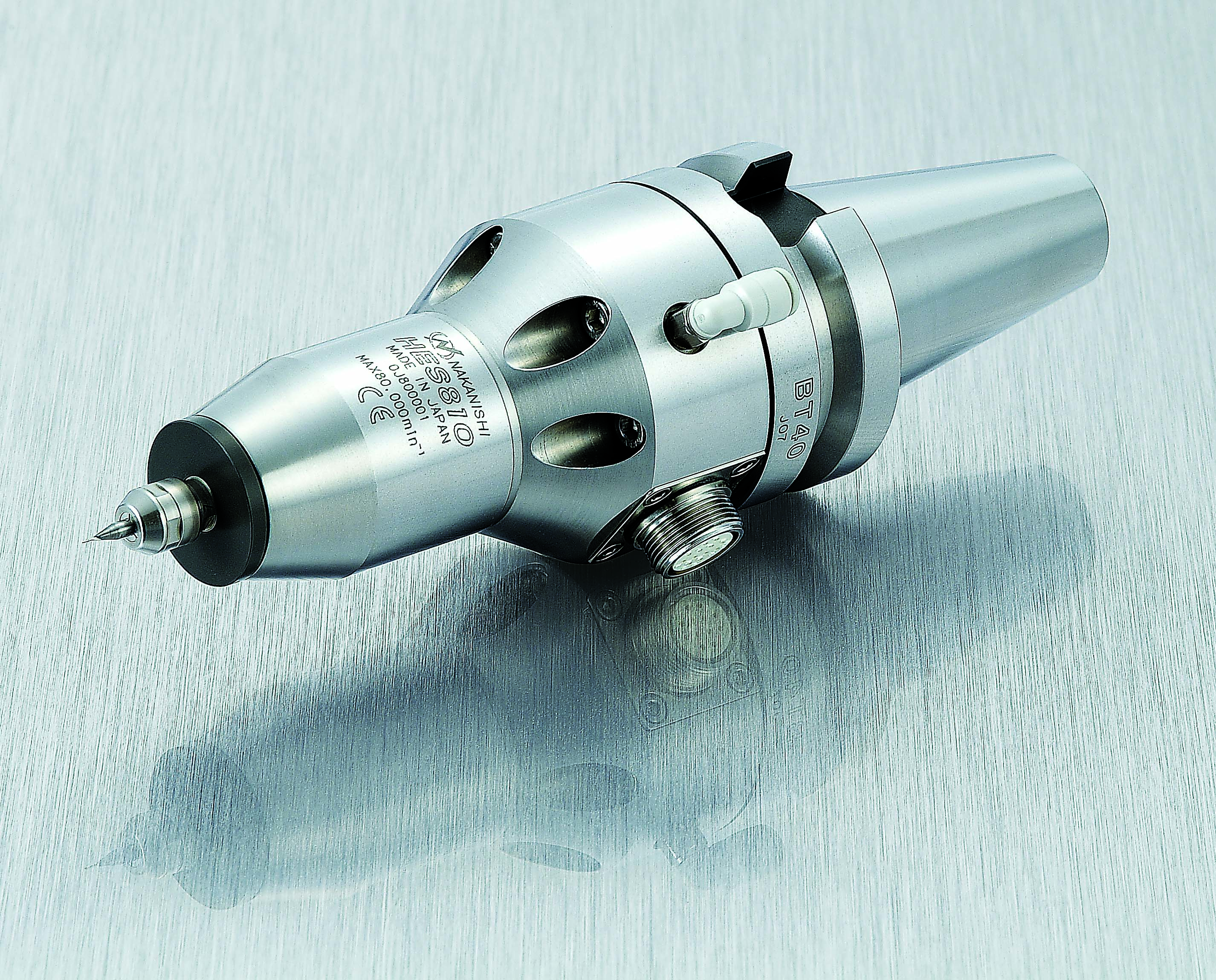

Perhaps the most effective way to eliminate wear and tear on machine spindles is to leave them turned off. That’s according to Mike Shea, product sales manager at NSK America Corp., Hoffman Estates, Illinois, who said an auxiliary air or electric spindle provides speeds up to 80,000 rpm and greatly increases the capabilities of even the most basic machine tools.
Just don’t call it a speeder. “Around here, that’s a four-letter word,” he said. “With an electric spindle like ours, the machine spindle remains static. There is no need for machine spindle rotation. This is the opposite of a speeder head, or ‘multiplier,’ which relies on machine spindle rotation to operate.”
An electric spindle is an excellent way to avoid machine wear and tear. Photo credit: NSK America
For some applications, an electric spindle is an excellent way to avoid machine wear and tear while achieving high spindle speeds. Image courtesy of NSK America
For example, a moldmaker might use one of NSK’s electric spindles to finish or semifinish a large mold cavity. Or a medical parts manufacturer could use an electric spindle to drill a series of tiny holes or mill miniature part features. Because electric spindles are rated for continuous use, there’s no worry about running them around the clock. One downside, however, is the need to disconnect the motor cable and air cooling tube before changing a tool.
“There’s always some give-and-take with an electric spindle motor,” he said. “You can spin them wide open for as long as needed, but you have to understand that you’re dealing with a 1⁄2-hp motor, not one with 10 or 20 hp. That means light cuts and high feed rates. As long as you can work within those guidelines, they’re a great solution for a number of applications.”

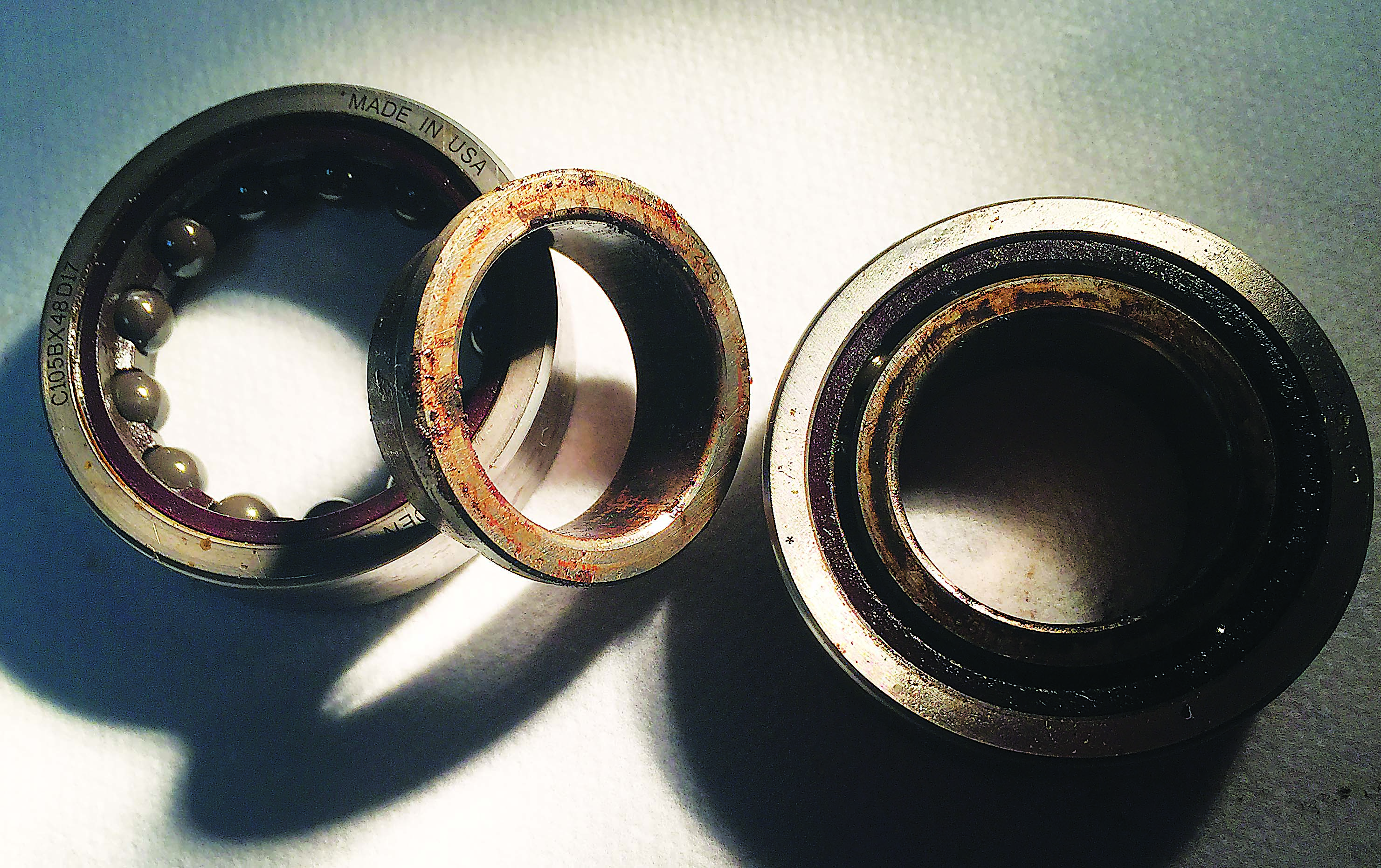

The belief that drier air is better may not be true across the board with machine tool applications. However, the idea certainly is valid in the context of the air supply to machine tool spindles.
More often than not, poor air supply to spindles is a significant factor in premature machine tool spindle failures. Whether the air supply is dirty from particulate contaminants or more predominantly moist, such contamination can be disastrous.
Maintenance personnel and operators alike too often focus primarily on proper lubrication supply to spindles. Yes, lubrication is extremely important, as improper configuration can cause immediate spindle failure. But a contaminated air supply is what we refer to as the “silent killer” of spindles.
An estimated 80 percent of spindle failures are because of contamination. The assumption often is made that contamination is caused by ingress from an external source—for example, grinding swarf or coolant. End users might be surprised to learn that in many cases they are slowly but surely killing their production lifeline: spindles.
Users might be surprised to learn that often they are slowly but surely killing their production lifeline: spindles. Photo credit: GTI Spindle Technology
More often than not, poor air supply to spindles is a significant factor in premature machine tool spindle failures. Image courtesy of GTI Spindle Technology
The following is a case in point. A large, well-known, experienced Pennsylvania-based automotive parts manufacturer routinely runs 24/7 production utilizing Bryant high-speed ID grinding spindles. In 2016, the manufacturer’s spindle failures required 40 repairs, with contamination failures representing 80 percent of those. GTI Spindle Technology Inc., Manchester, New Hampshire, worked closely with the end user to track and trend these failures, not only by the spindle serial number but more importantly by the serial number for the machine tool that the spindle was deployed in.
Today, after diligent teamwork, routine cause-of-failure assessments and machine tool assessments, the spindle failure rate has dropped by nearly 50 percent. The reason in this case is because drier is better.
The auto parts manufacturer purchased and installed a three-cell dryer. Its overall capacity is 7,500 ft.³/min., so the company only ever needs to run two cells at a given time. The advantage to the three-cell dryer is that one cell can receive maintenance without stopping production.
Cooperative identification of problematic machines and subsequent implementation of the air dryer system to support the machine tools have dramatically lowered spindle contamination failures.
