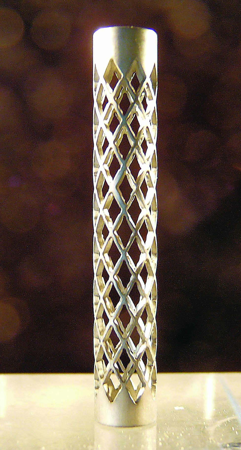

This titanium mesh cage was produced in the MicroMax JetMachining Center.
