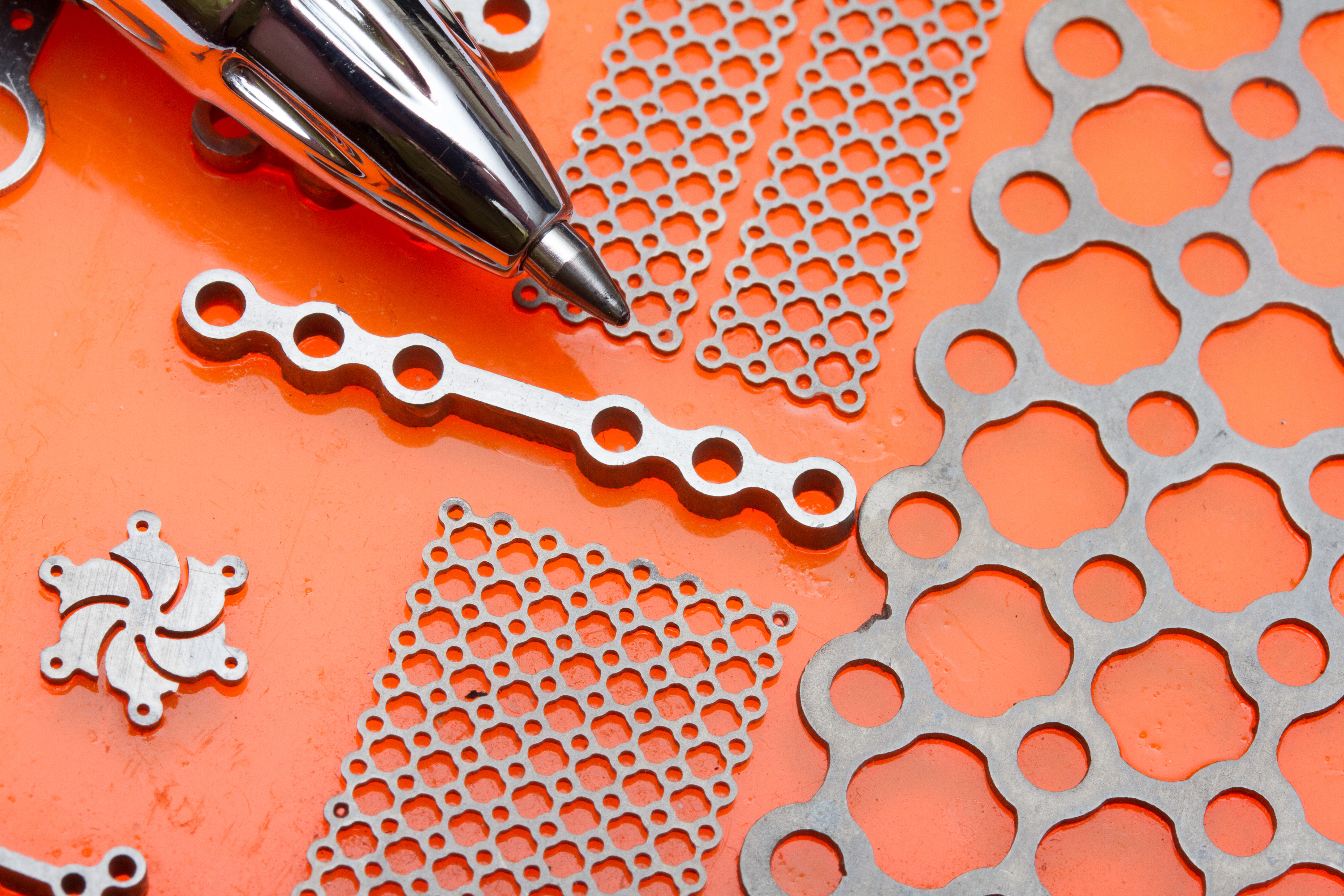

Hyperspecialized scripting can shave hours from time spent on part production. These small parts benefit from automated alignment and optimized piercing. Image courtesy of OMAX

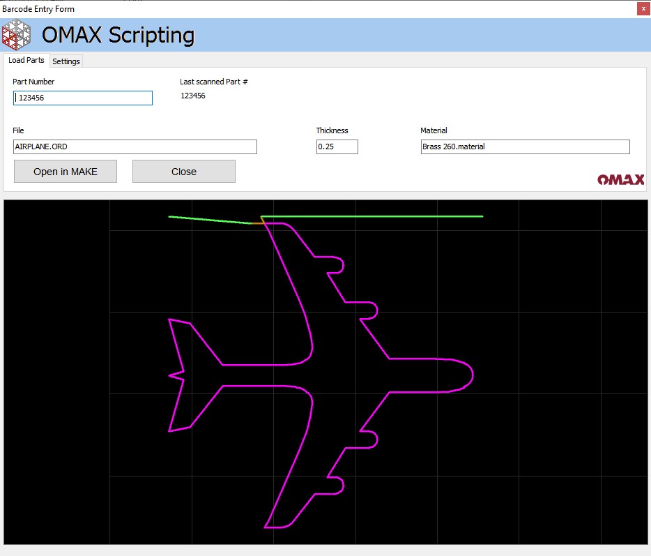

"We have used scripting to help users integrate a waterjet into their existing processes," Thomas said. "If all of their machines are set up to use bar code work orders, we don't want the waterjet to require a different process. So applications have been written to take bar code input and match it to a specific file, and sometimes we also link the material and thickness. Another example is import filters for file types that are already in use in a shop. We've written a few CNC G-code importers, so the same files are used for all of a customer's equipment."
