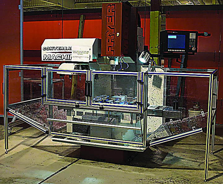

Hybrid guarding solutions utilize two or more safety product lines to create a custom safety solution. This one uses T-slotted and electronic safety devices to create a machine enclosure. Image courtesy of Faztek.

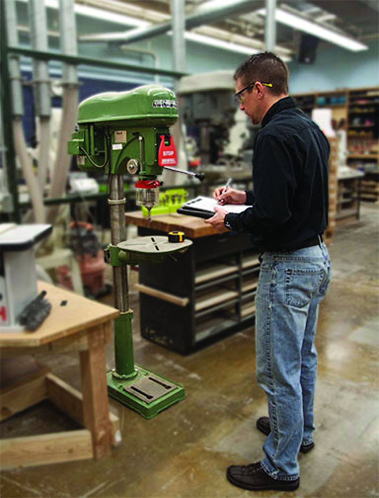

Matt Brenner, vice president of sales at machine safeguarding specialist Rockford (Ill.) Systems LLC, sympathizes with companies subject to OSHA regulations.
“For end users, it’s very difficult to get through, analyze and understand what the standards are and what they mean—basically, to interpret them properly,” Brenner said. From an application standpoint, it’s hard to know how to make a machine comply while maintaining a high level of productivity, he noted. “I can’t stress enough that the standards are complex, the machines are complex and many times the machines’ usage is complex to the user.”

Matt Brenner, vice president of sales at Rockford Systems, conducts a machine safeguarding survey. Image courtesy of Rockford Systems.

This machine guard uses a T-slotted frame and clear panels for easy viewing while keeping sprayed fluids contained and off the ground to prevent slipping. Image courtesy of Faztek.
